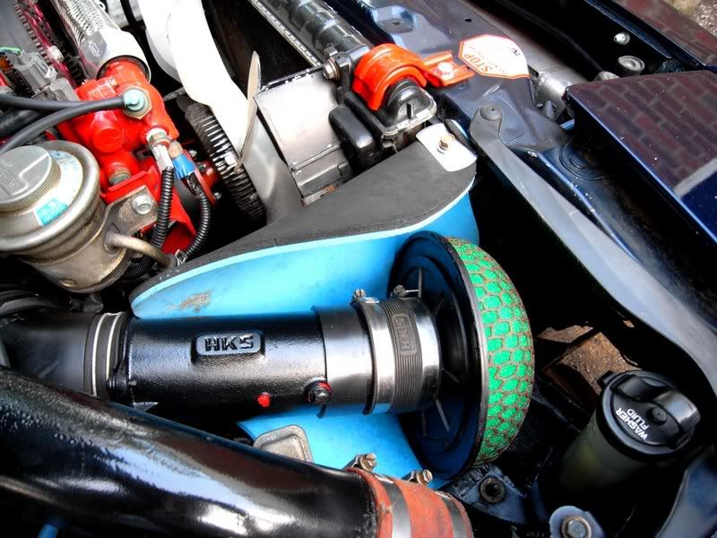

I had to get a new filter and I couldn't get the setup to work anymore so its back in my engine bay.

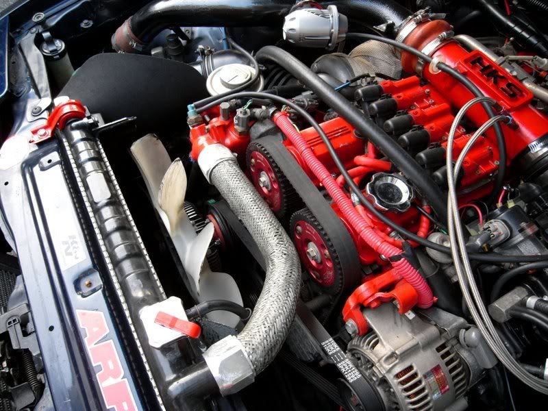

my car is NA, but as you can see, the headlight covers' scoop directs air straight into my HKS filter when the headlights are up..

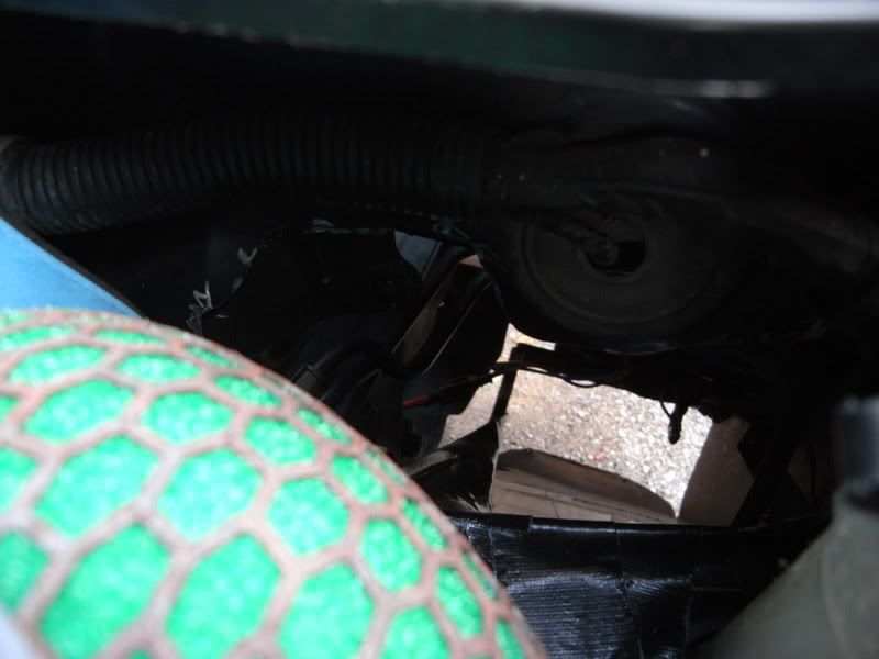

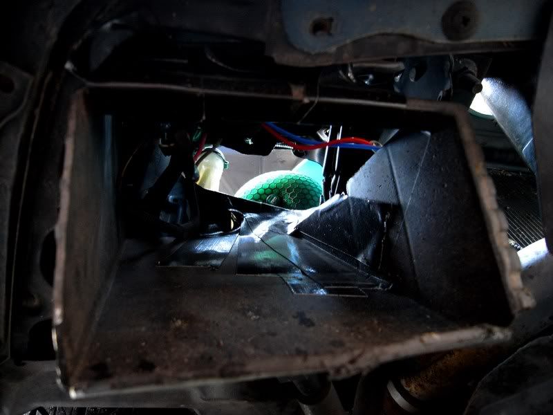

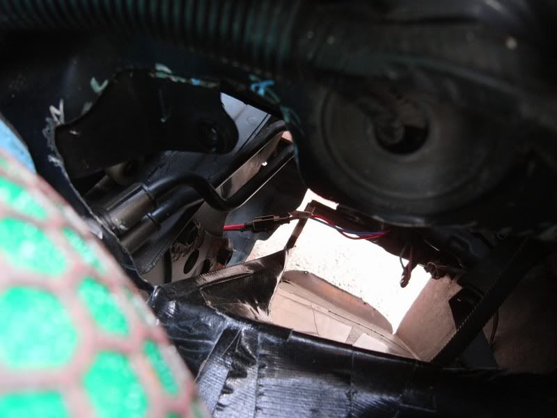

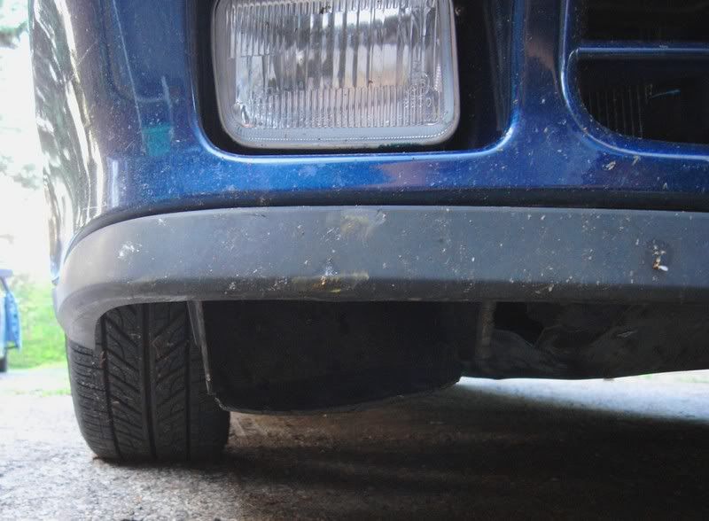

Here are a few shots I threw together for someone else who asked about this... I'm not drawing THROUGH the fog light... but JUST underneath!:biglaugh:
There's how it looks at the moment. Everything is "rough installed", to experiment. It appears to be a noticable difference, so I am keeping it, until I can "improve" on the execution. I may "seal off" the area around the "cut hole" and the HKS filter, to make it a TRUE CAI with no "bleed-thru" from the engine compartment. Still playing with ideas.
You can see from the last shot that the filter is well separated from the engine compartment already. I am pleased with the concept.
(Try to overlook the "untidied" wiring, etc... and the duct tape... what can I say! DT FTW! HA!)
G/L with your efforts.
