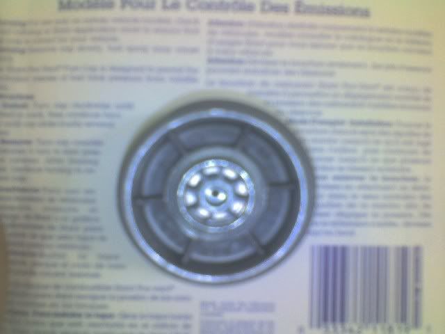

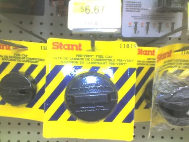

Many have wanted to remove the charcoal canister. The easiest way to deal with the fuel vapors is to simply cap off the line and install a vented gas cap, but it doesn't seem like they make any for our cars. It's been asked many times, but I've never seen it answered. Where can I find a vented gas cap?
Solution:
Go to your local Walmart (or anywhere that carries Stant gas caps) and buy yourself a cheap #11819 pre-venting gas cap (fits perfect).
Then just drill out the piece that pivots on the spring (the vent stopper). Simple as that. I decided to drill down a little further and expand the actual venting hole to allow the cap to vent faster. Probably doesn't need to be done, but couldn't hurt.
For those of you looking for a vented cap that needs no modification; sorry, don't know what to tell you. But if you can't drill out a little piece of plastic then you should probably just get outta the game :biglaugh:
