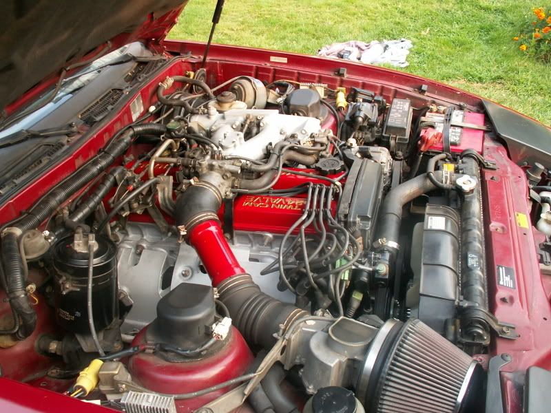

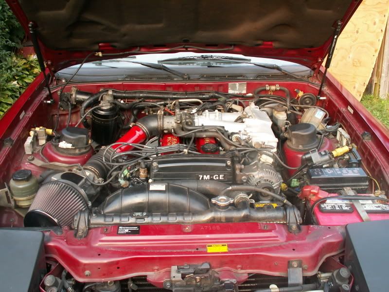

Well, I retorqued the head and I changed the coolant and the oil/filter.
Good thing I retorqued the head. Some of the bolts were to spec, others were off as much as 15ft/lbs!!!
Anyway, I retorqued them in proper order to 73ft lbs and she is good to go.
There wasn't as drop of coolant in the oil and the coolant was very clean too.
My hats off to you guys who can do a retorque in an hour!!! It took me 2.5.
Here are a few pics!!!

That is one clean engine. I like how the valve covers kind of blend in with the color of the car.
I'm NA also and I think I might need a rebuild. I'm hoping at least not for another six months.
