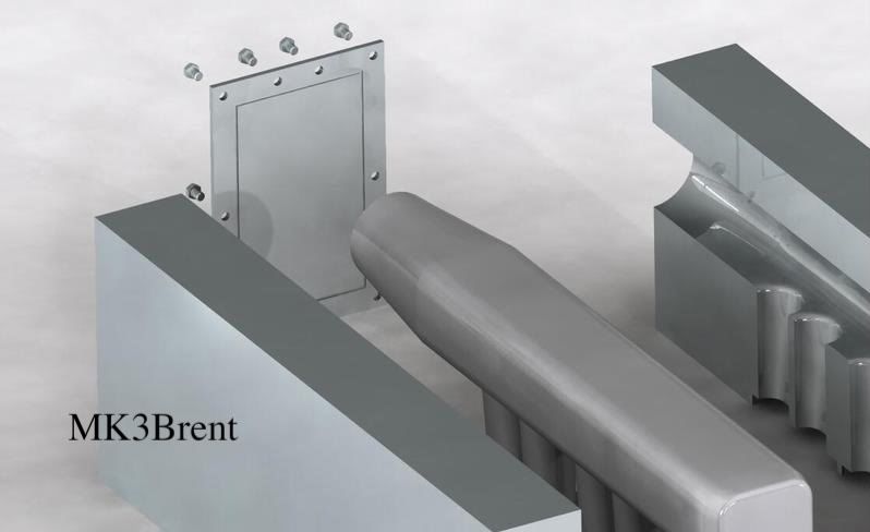

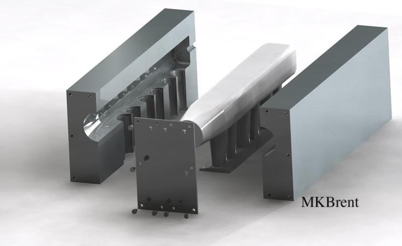

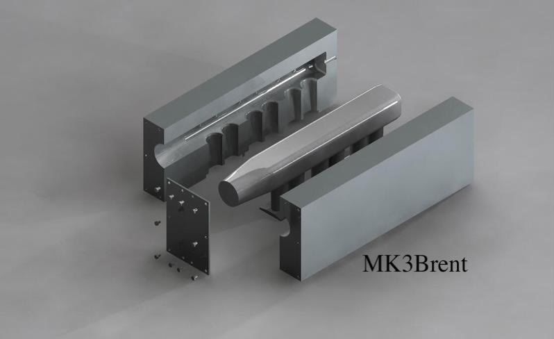

How else do you do it? This would be my first shell style mold, so I'm still learning. What I've done for instrument transformers is relatively simple (the entire piece become encapsulated similar to this: )
So I figured I'd have to make a mold that produces one solid core insert... then that insert would be centered within the other 2 pieces.

Err excuse me for not saying it correctly. When I said "3 piece" was was only refering to the outside casing. Yes, you will need a mold to make the core, then put the core into the shell mold.
So what I was trying to get at was: have the shell mold in 2 pieces. The shell mold would include the TB flange, plenum, runners and intake flange (2 sides). The runners of the core mold would continue past the flange(s) and be clamped by the sides to hold it in place. I'm not sure if that works with the setup you have but that was just the first thing that popped into my mind. I don't know how reliably you can actually bolt something to a core piece.
We have a new mold guy here, I have no idea what he knows about casting or cores but I'll ask on Monday. Hopefully I've cleared up what I meant to say, if not I'll draw a picture or make a model to better explain it.

Yeah, I see now what you're saying.
I had planned on keeping the flange features in the final cast of the shell... which might be easier, I dunno.
I'll work on it more next week.
