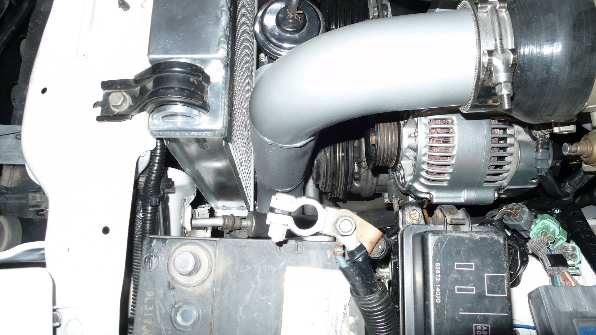

adampecush;1478977 said:
It was extremely easy to run it between the radiator and AC compressor....and no cutting was required.
Here is a pic of my set-up with a koyo radiator and 2.75" piping.

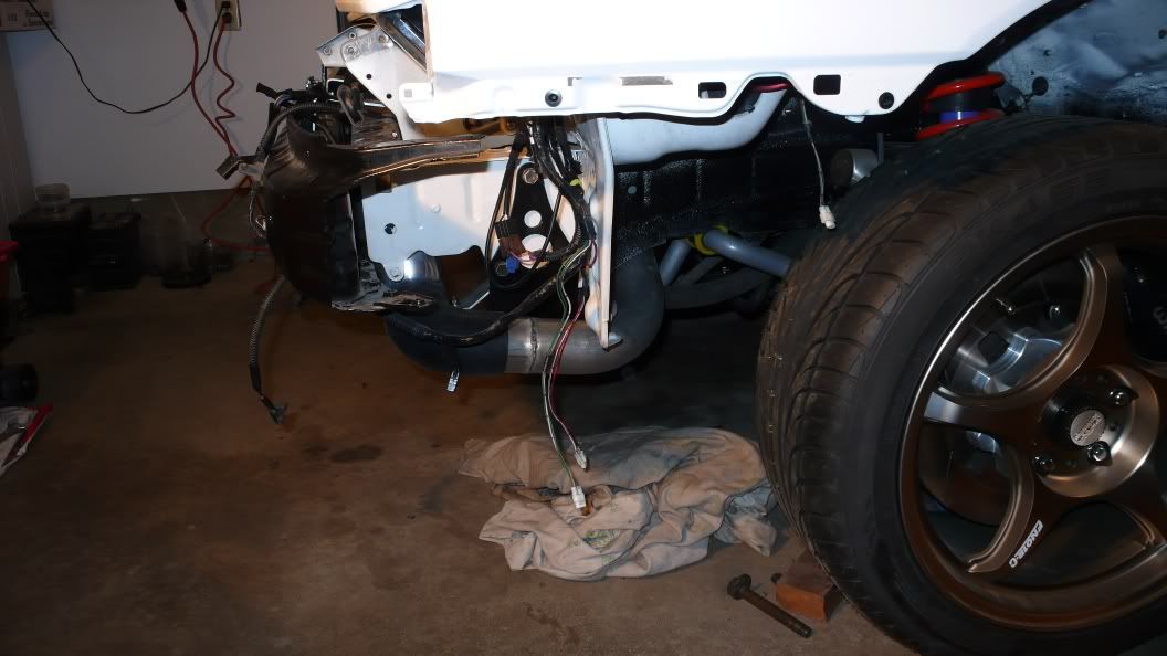

You had to get rid of your aux fans, right? Do you have any pictures of the routing to the intercooler? (once it gets below the radiator)

something like this?
yes, the aux fans had to come out, but the added capacity of the radiator should take care of things (no issues so far). if not, a pusher fan will have to fit the bill.
Did mine the way it is so it could retain the stock Shroud and Fan Adam.
I've got the majority of the stock shroud still intact, but ditched the aux fans - So far I haven't seen any significantly high temperatures running this way, so it seems OK.

Anyone have any hot side pictures? (besides Ian)
