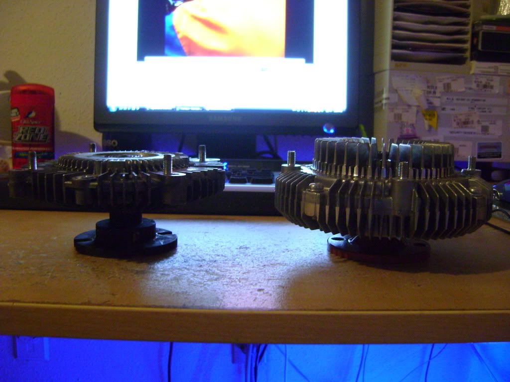

Advance Auto fan clutches suck. They are tiny compared to OEM.

JUST BUY A NEW FAN CLUTCH. 40 BUCKS AT ADVANCE. LOL i just bought one.
that is very true. i wont argue with that:) but it works and its a fix untill you can get a OEM fan clutch or fix yours.

When cold it should spin freely but have a little bit of resistance. When you start the car cold the fan should engage a little bit for about 10 seconds and then it will slow down and just slip. When hot it should still spin but have a bit more resistance than when cold. Is it a oem fan clutch? Or Autozone? My old autozone clutch was noisy almost all the time unless I was on the freeway.
