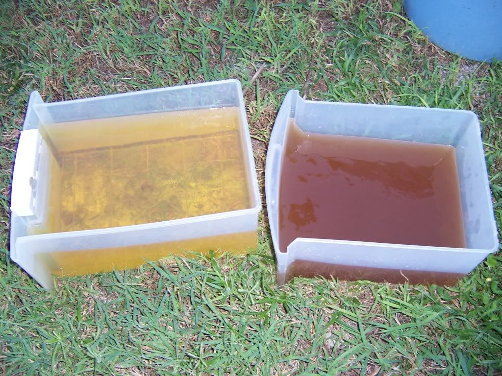

Gas on left is what initially came out of the tank, without having done anything (mind you this gas was a only a few days old)
Gas on right is what came out after one cycle of shaking the beads in the tank.

lol, I was told after I had done it that it was an old school trick. I had been pondering doing this for months, but didn't have the money for both the fuel filters (I changed the one in engine bay too). Then the car gave me no other choice when after a 100 mile jaunt in the Everglades nearly ended in my being stranded. The fuel filter on the pump was like... sucked IN to itself and covered in a ton of rust particles.
What you CANT see in that picture, of the red gas, is all the black sandy shit on the bottom. My injectors must like being able to work properly now, but I can only imagine how horrible my plugs look...ugh.
