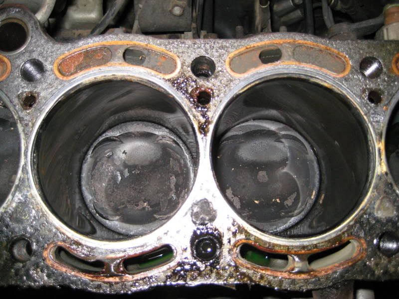

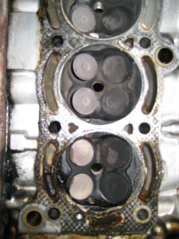

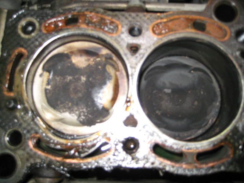

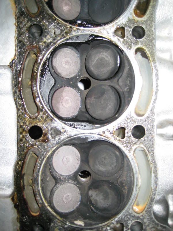

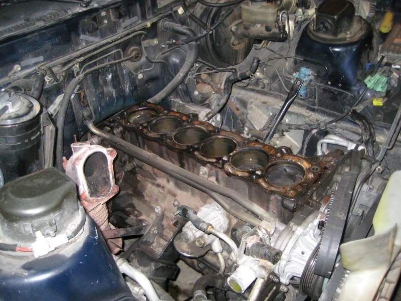

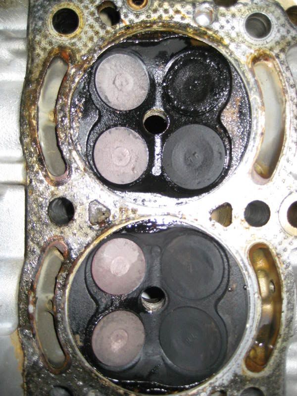

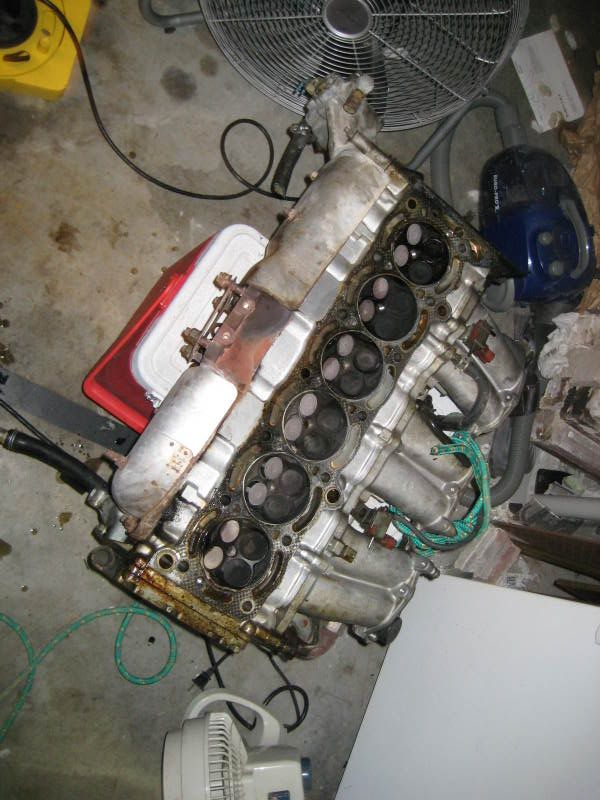

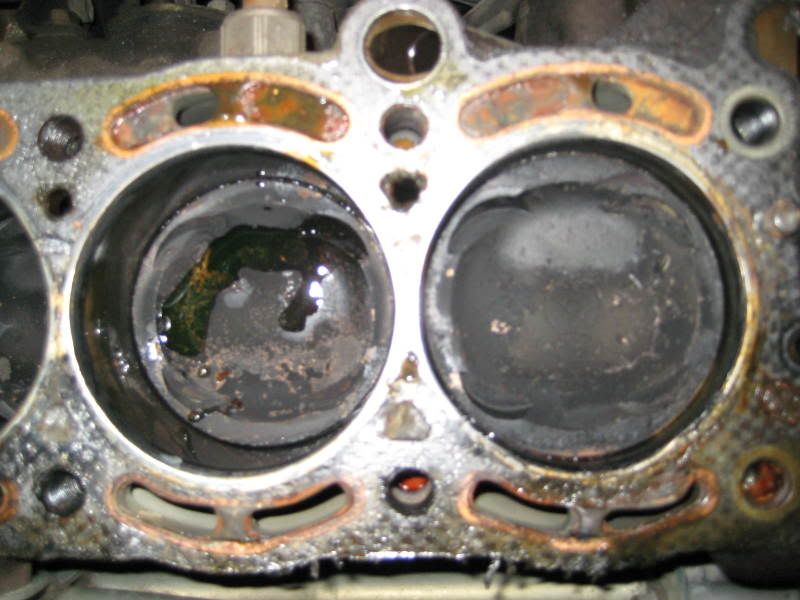

Thanks for the advice everyone, i got my head off tonight. turns out my gasket was at least slightly blown in cylinders 1,2,4,5 and 6. heres pics!
Cyl 1&2
Cyl 3&4
Cyl 5&6
the head!!!!
1&2
3&4
5&6
Just from looking, can anybody tell me if thats a MHG, or the stock one? I know that the stock headbolts were in there..... :3d_frown:
