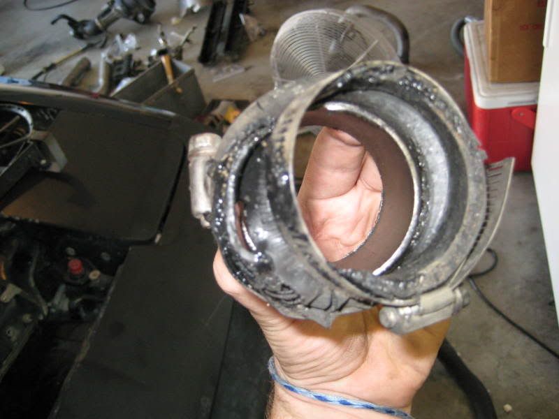

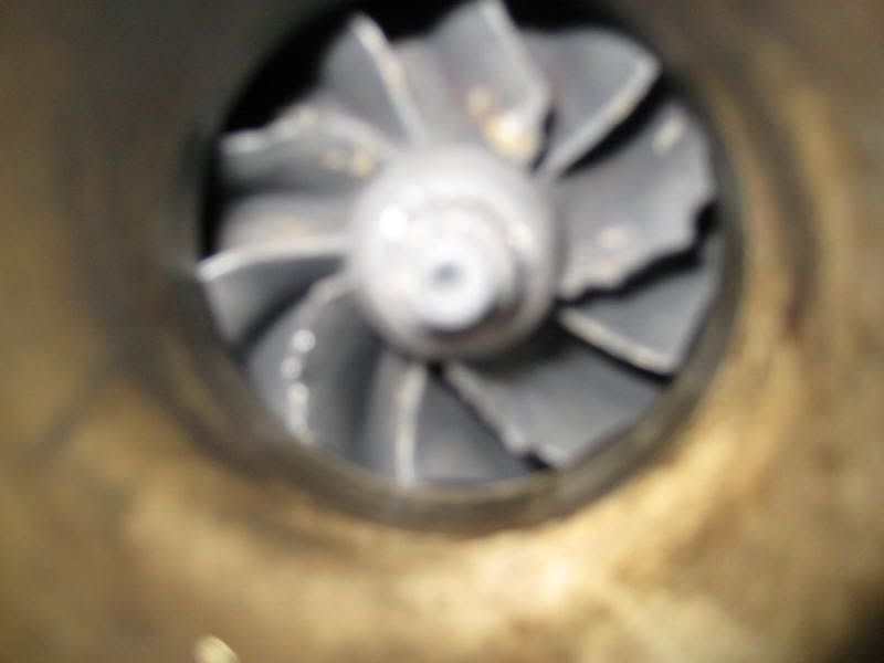

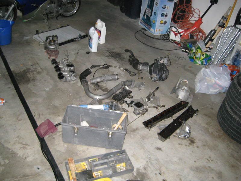

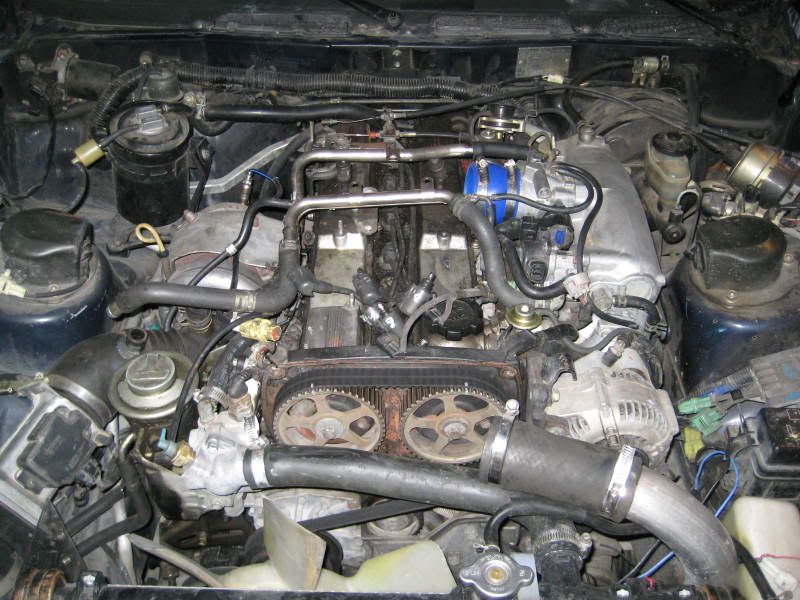

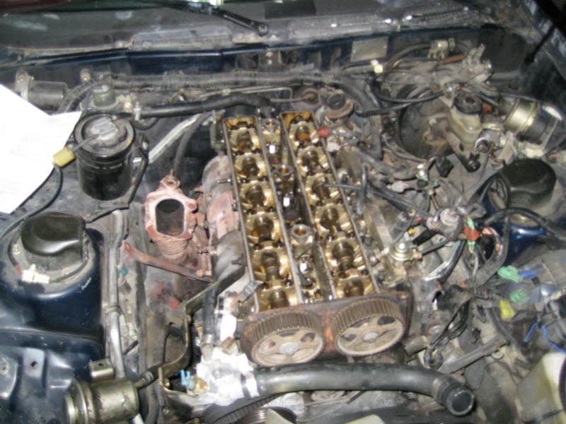

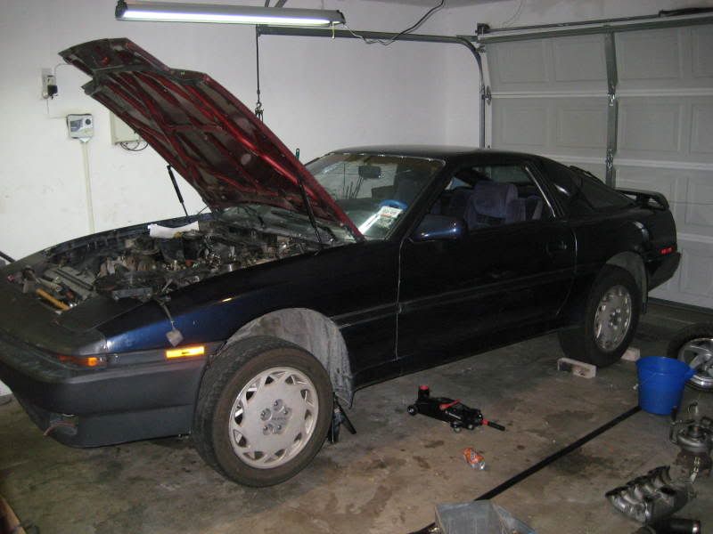

Okay, heres the pics of what i have so far, as promised:
The car: '87 sexy blue
right after i started
pile of parts on the floor
so THERES my vacuum/boost leak
The engine disassembly so far
The old stock turbo's nasty turbine, putting a 57 trim from driftmotion in when it all goes back together

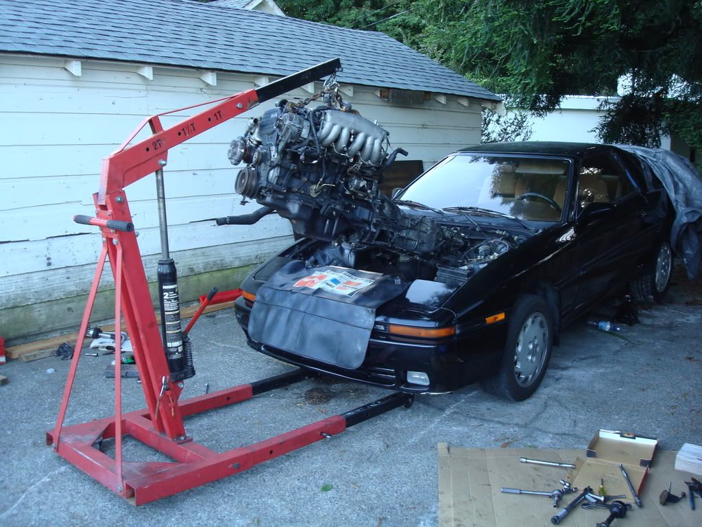

subjub4tor here is a pic of the last time i pulled my motor to give you a idea of a good approach if you cherrypicker doesn't go that high.
