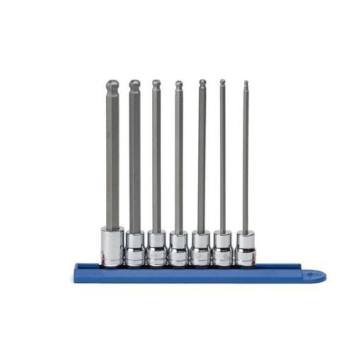

i used these to remove the stocks head bolts on my 89 and my moms.I wondered why they had that skinny section at the bottom and metaphysico mentioned oil in the dead of the bolt,i figured that's why it was.Am i right? it also made a really good section on the bolts that made removing them a breeze.
they are Kobalts i got at lowes.
No... the ball end allen keys are designed so that they do not need to be straight in - they work at an angle as well. Unfortunately, they sacrifice a fair bit of strength for this feature, so it's not uncommon to see these with the ball end snapped off. There's no way I'd use a ball end on the head bolts...
