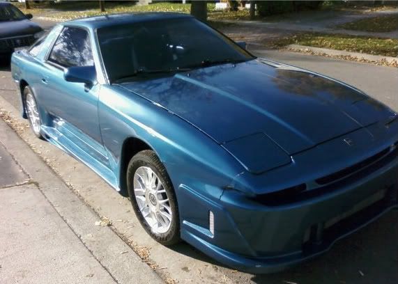

Poodles;1897097 said:
The car was designed around that trim, so without it, it looks...odd.
This..

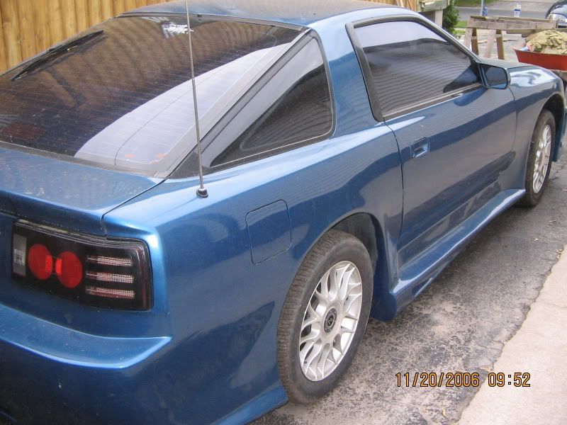

87supramario;1896863 said:
I
It looks fine as the door goes but under the tail lights and center tail garnish and the ousides of the front signal lights looks stupid. There is no way to avoid the oddness of it.
I hope I was here on time to save another MKIII from a horrible death
Another MkIII
Feb 22, 2009
697
Chicago
87supramario;1897147 said:
This..
o_O Dear God, that owner should drive that thing off a cliff.
