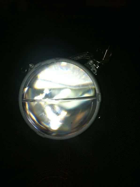

hvyman;1662367 said:
Wow yours are complected but look really good. I dont get why/how you blacked it out. Also do they pass through 2 lenses 1 black and 1 clear (what it looks like)
The ones on my car are just some tsx setup glued in to the stock sealed beam so there is no custom mount.
I have these off a hyundai genesis. They look good but i doubt they are the best at all. What are your thoughts?
http://i46.photobucket.com/albums/f139/kcaine/ecacb79d.jpg
http://i46.photobucket.com/albums/f139/kcaine/a094f9c9.jpg
http://i46.photobucket.com/albums/f139/kcaine/32d95bd4.jpg
http://i46.photobucket.com/albums/f139/kcaine/755757d5.jpg
Still waiting to get another set to make some custom ones. Or just find the time to hack apart mine and use both of what i have.
Thanks! I spent a decent amount of time on them! It's an illusion with mine, I blacked out the cutoff shields with very high temp paint. It doesn't reduce output, but gives it a blacked out look. The way the e36 ellipsoid headlights are set up is like this in factory form:
halogen projector/lens -> low beam lens with fluting to direct light-> outer glass (squareish) lens.
With my retro, I drilled 70mm holes in the low beam lenses so that the projectors can pass through them, thus making one less lens that the light has to pass through. It also allowed me to set the projector as far forward as possible while still looking good which makes the beam wider on the road.
I haven't read anything about the Genesis projectors yet. They look a lot like older Bosch projectors used in some BMWs. While the output is decent, the beam width isn't fantastic on them. However, I haven't seen output pics or anything from the Genesis projectors yet so I'm only speculating.

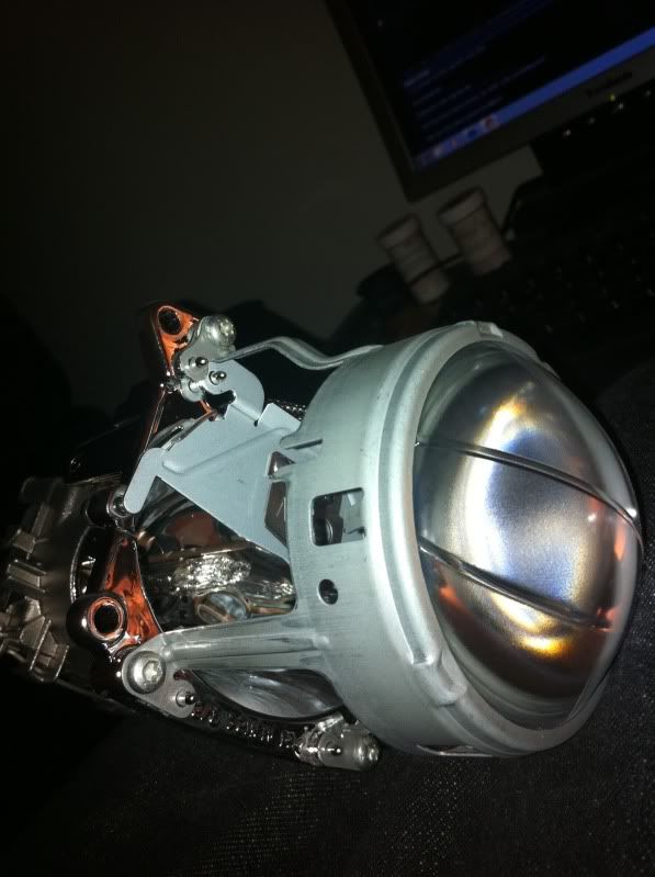

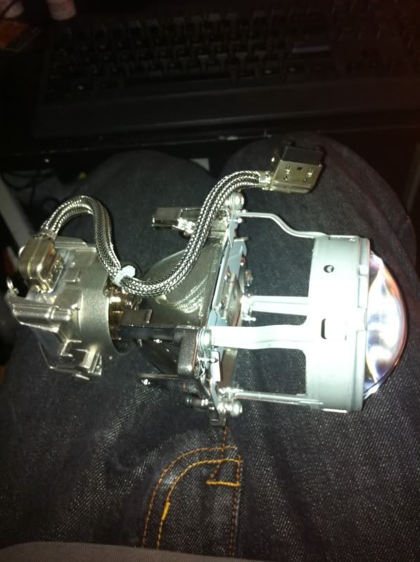

Mine only have one lens on the actual projector. I think my wording might be a bit confusing. The other lenses are part of the headlight housing and are there for protection only. The high beam lens is there for fluting/directing the light. Here are some other pics of the FXs:
The cool thing about the FXs, aside from their small size and relative ease of retrofitting, is that they're bixenon. That means hi/lo beam. Since it's hi/lo, it uses a magnetic coil, which, when energized, pulls the cutoff shield down, thus allowing the xenon bulb to illuminate more of the lower part of the projector bowl. (It is the lower part of the bowl that produces high beams) Here's a pic of the magnetic coil.

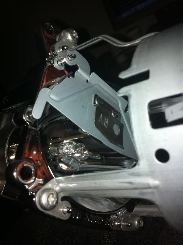

OEM cutoff shield. Note that it's a double shield- this makes the cutoff fuzzy. Removing the second shield makes the cutoff nice and sharp. Also helps with making that pretty blue line at the cutoff. You can also see the magnetic coil where it attaches to the shield. When energized, this coil sucks the shield down, thus producing high beams in addition to the light being produced by the low beams. Lots of usable light FTW!
You can see the double shield here, and understand why it makes the cutoff fuzzy:
Modified shield. I also blacked it out, but no pics of that. The blacked out shield is what gives the projector lens that black appearance when you look at it, but does not reduce light output. This pic is taken from the BACK side where the projector bowl/bulb would be. This is looking through the projector lens as if you were the bulb.
