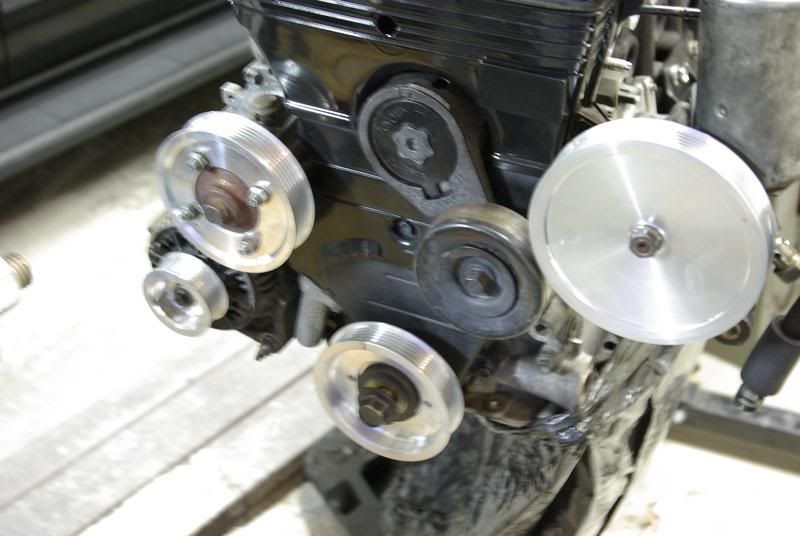

I came across a thread on SF where Sean from Titan(high hp 2jz mk3 owner) comments on a photo of a 1jz with the DM underdrive crank pulley. "That crank pulley will not work, imminent fail!"
Makes me begin to start thinking, I have one on my 2jzge Na-T(motor still under contruction out of car).
Is it good to use? Any possible "failure"? HP limit? Rev limit?

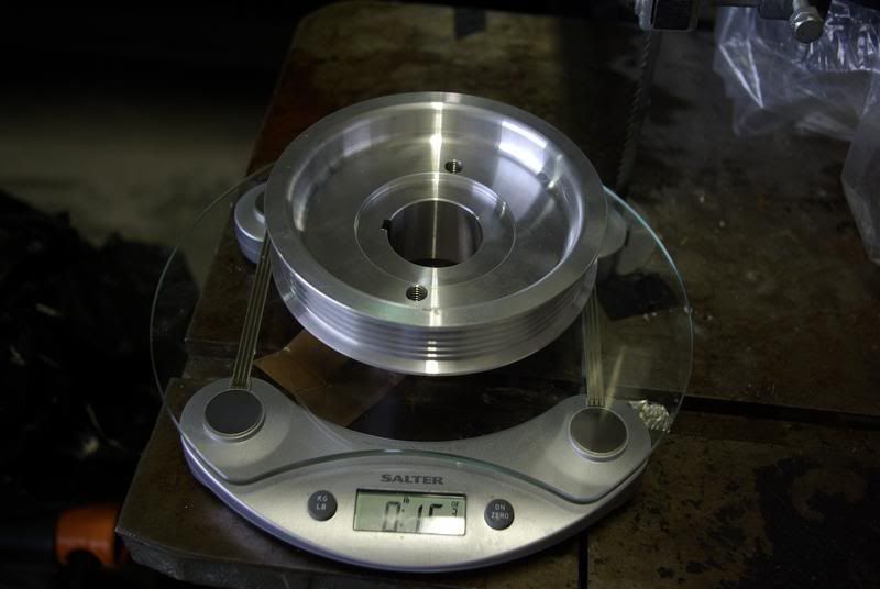

Oh and by the way the DM pulley weighs 16oz.(1lbs.)
Photos for those who dont know what im talking about.

No harmonic balancer = fail. Fluidampr is one of the only aftermarket pulleys that I'd consider.
