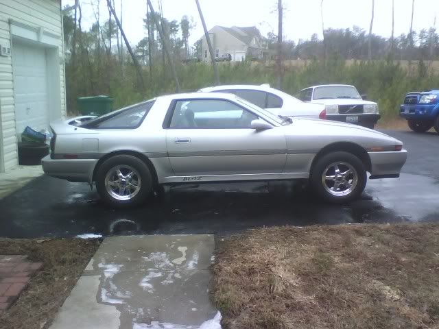

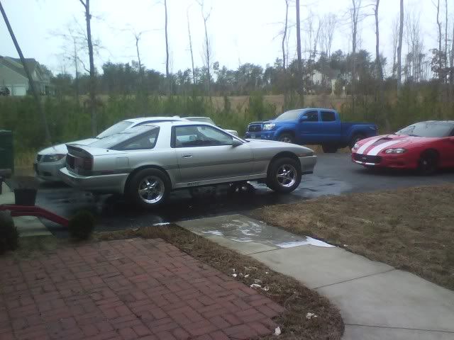

Here is mine, crappy cell picture. Any way, just front runner that use on my camaro. There not mounted just rolled them in front of exsisting wheels that on the car, so I can get the idea of how they will look. Soon to get matching backs, Greg Weld 15x8 with 5.5 back spacing with 275/60 MT drag radial. The Greg Welds are uni-lug.

Great looking wheels Slow!!
If I buy another set of wheels, they will be the Greg Welds because I like the way the spokes are and they are much thinner than the Welds that I have. I'd like to get a set of them and powdercoat the spokes black. I think if I did that with the wheels I have now it would look funky.
