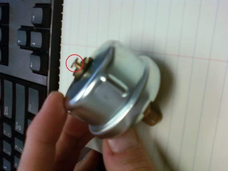

I have a DM stainless adapter line and a new 7M sender. I already have my 1JZ in the car with the AC compressor and radiator all hooked up. I didn't realize at the time how difficult it would be to get the DM line onto the block with the motor and such already in the car. Would it be easier for me to just get one of these "sandwhich" plates and put the sender on it? Also, does a wire connect to the sender or does a separate wire communicate to the ECU?
I would just remove the ac while you put it in. Doing a sandwhich plate will be just as, if not more difficult with your engine in-car.
A wire connects to the sender, Yes. Are you asking where the wire goes to?

Yes, I was asking if a wire connects to the sender, and then where the other end of the wire that connects to the sender goes. It just doesn't look like there is any connection on the sender itself for an electrical wire, that is where I'm confused. So the wire connects to the little metal disc on top of the sender then?
6,618
Appears to be like the oil sender in my Mk2, a 6m. If so, then there should be a wire with a connector that attaches to the little disc part of the sender you have circled in the picture above.
mkiiichip
Sep 10, 2007
1,434
WI
This kind of connector, connects to the top of the sender. And the wire would lead through the engine harness, to a connector in the ECU area. Eventually going to the dash.
