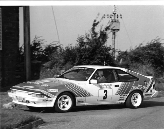

This is the car:
It won the British Open Rally Championship Group ‘A’ category 1985.
this is a post hinting at the engine work. he doesn't give full disclosure but it sounds like it has had some extensive prep work.
http://forums.celicasupra.com/showpost.php?p=332190&postcount=12
and this is a thread about it:
http://forums.celicasupra.com/showthread.php?t=18945&highlight=Supra+BTCC
more pictures here:
http://forums.celicasupra.com/showthread.php?t=28616
although vague, the power level must have been considerably high to compete with the rest of the field. Hell, it actually beat them.

The British open rally and the Australian Bathurst are two very different events.
Here's a pic of the car.
From memory the guys a regular on toymods and his sig is "art racing", he bought parts off me when i was wrecking a ma61 and he told me some of it's goodies that blew me away.

My apologies tyre shredder, i didn't realise he competed overseas with a different colour scheme.
Yes that's the same guy his name from memory is "john".Hmmmm i still have his number.
