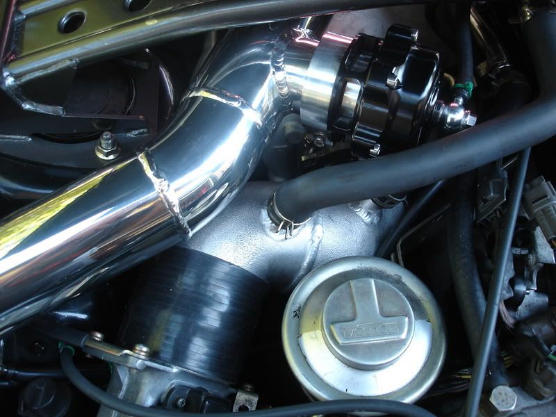

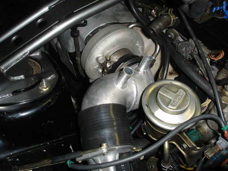

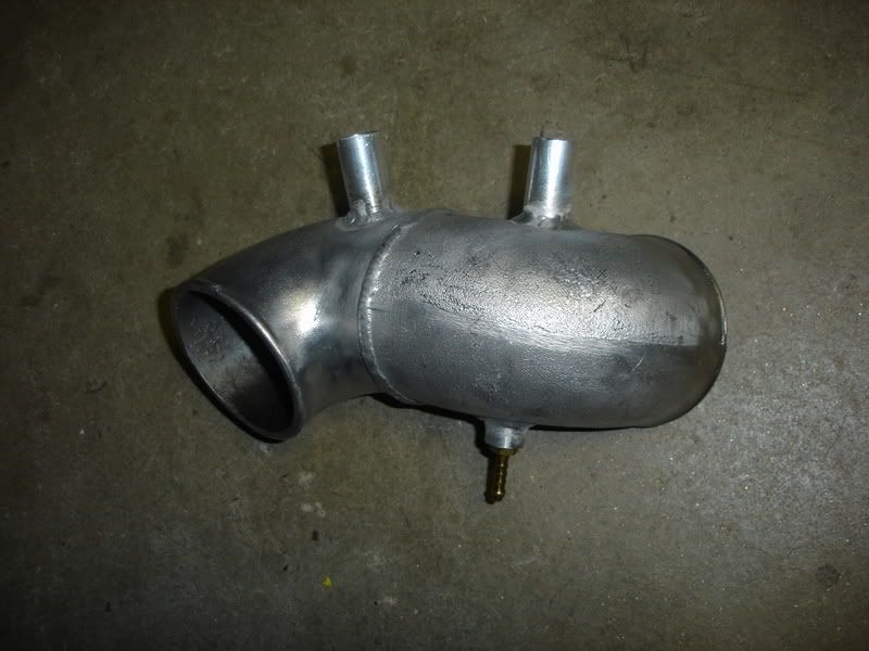

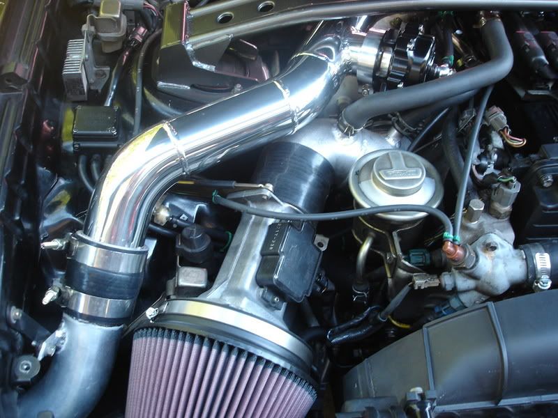

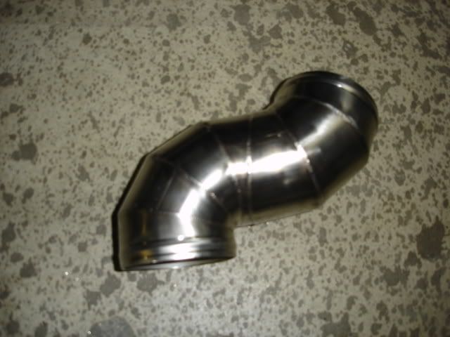

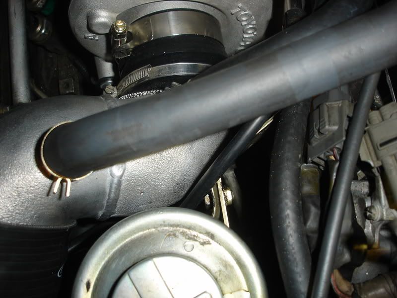

I figured I would post up a few pics to see what everyone thinks. I made this for one of the local supra guys and his clean ass 92. I also built the intercooler set up in the pictures as well as alot of other stuff. It is a little bit bigger than 3 in so it matches the AFM perfectly.

I only have three words to say, Hard Tuned Motorsports, nuff said! :icon_surp That intake pipe is tighter than JDM TYTE! Darian, can definitely fabricate! Whoever Supra that is got one hella JDM TYTE i/c piping set-up! :aigo: If I had another Supra, I would have him do the work again!

VERY Nice welds!!!! you did some great work. i also like the second piece w/ pie cuts.
what is the ID of your first piece? the only thing i cant get on-board with is the wall thickness due to the cast-icity of the elbows you use. other than that, man its nice!

I dont have the measurement off hand but it matches the AFM perfectly. The casting isnt as thick as the standard elbows you see for sale.

im guessing the wall thickness is 0.125" then. that would put your ID somewhere around 3.25", maybe a hair smaller.
i ordered 3.5" tubing for my intake, as well as the appropriate couplers to install it. i had to use the 3.5" since my Lexus meter was 3.5" OD so it fit perfectly.

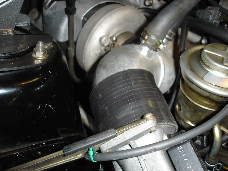

i really need one too. but i dont have an afm. so it would have to be 3" to 3" with same air filter location as though i did have an afm.
my accordian hose is ghettorigged right now since it wont fit over my turbo. my accordian hose goes to a 2in adapter to the 3" inlet on the turbo. and im not running an afm so i cant use the power steering resivior bracket, so its on an angle.

Do you have a pic of your set up?

I smell group buy.... I think it looks alot better that the cooleeze one... if you do make a one time batch you could do it as a group buy.....but either way I would like one.... but would like it with 3 ports like the stock accordian hose.... plus one on the bottom for the powersteering pump...
