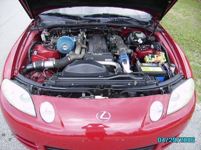

on a side note, heres a 1jz swapped into an S14 that i saw last week at HIN

^^ Thats an SC300 not an S14. No way a 240sx has that much extra room in the motor compartment lol..
1jzgte SC300
2jzgte 240sx
