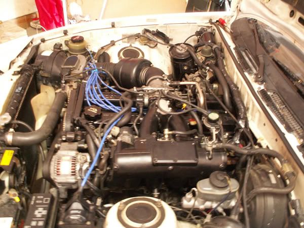

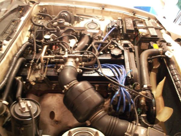

Crappy pics I just took. Tell me what you wanna see and I'll get better ones (AKA use the flash)
HommerSimpson
Dec 31, 2007
1,067
New Smyrna Beach Florida
how are you seting up number 1 on distributer ? you sure its at tdc on #1 piston and then the rotor pointing to number one well just past #1 i think it is.....
Ive only set mine up and im turbo... so i can only ask if you got it right... but maybe some pics of were the dist rotor is pointing with the timing marks lined up...it might be 180 Deg off...

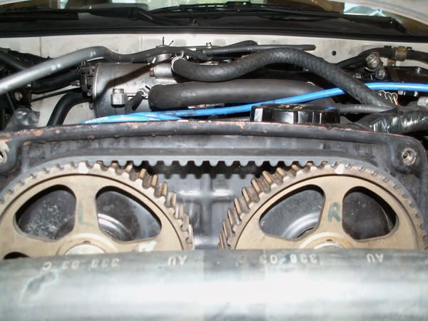

-Cams went in and I positioned them so the middle hole of the three at the end of each cam
was facing straight UP.
-Put the cam gears on.
-Put the pins in. Awesome! Cam gears are lined up with the timing marks.

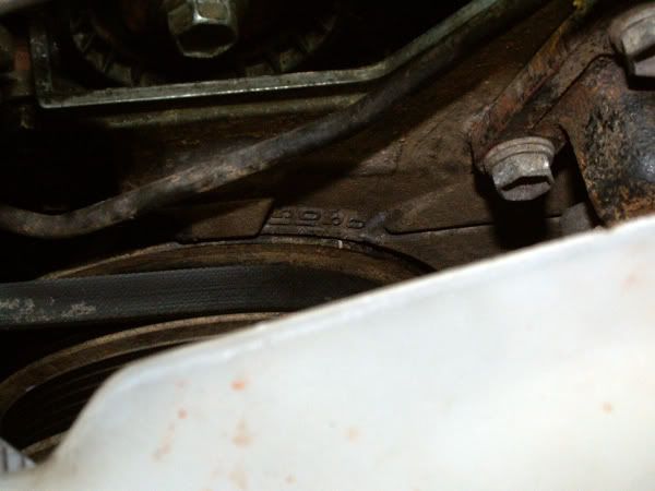

-Crank pulley was moved to the "0" marking.
-Timing belt went on and I made sure nothing moved.

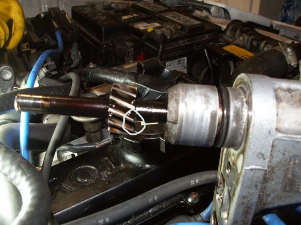

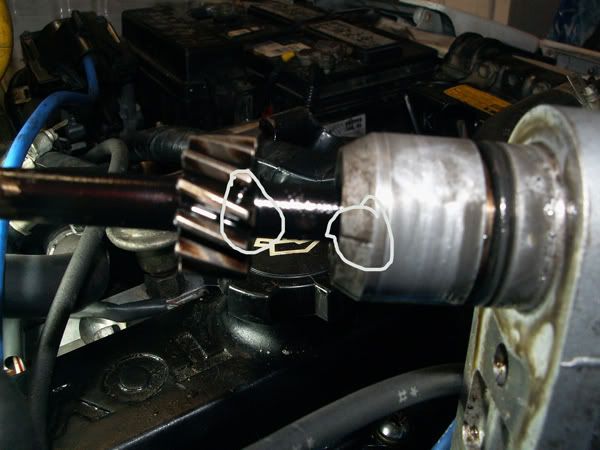

TWO PICS. I'm not sure if the gear is supposed to be set like the first or second pic. I'm not sure it matters too much when just trying to get it started. The difference between the two pictures are that in the top one the marking on the gear is about a tooth upwards compared to where it is in the bottom pic.
The only thing I havent checked like 4 times are the cam's position in relation to the cam gears as that requires me to take off a lottt of stuff.
What else is there?

If the crank pulley is at the "0" marking the #1 piston should be at TDC...
I'll go double check that its TDC though.
EDIT: Yeah its TDC.
