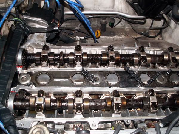

I looked through my oil cap at the cam and the top part of the lobe on the intake cam is supposed to be visible, says TSRM. Mine's off to the left. Looks like i might have the cams in wrong?
Is this how the cams need to be positioned? It seems like this would make the top part of the lobe visible from the oil cap.

On this page it says something different and this is how mine currently are. (unless I accidentally switched the cams or something)
http://www.cygnusx1.net/Supra/Library/TSRM/MK3/manual.aspx?S=EM&P=29

I'm amazed at how something so simple continues to stump so many people. It comes from not understanding the basics behind how an engine works. That said what's up with the painted marks on the cam gears? It doesn't look like the factory marks are under them.
The factory marks are indeed under the painted marks.

I don't think it's the cams. Check the #1 piston at TDC by removing the plug and placing a small wooden dowel (about a foot long) in the SP hole. Rotate the crank...if it moves up, you are not at TDC.

Just did that little test. Its definitely at TDC.
Pic:

No offense meant there guy. Just making a general statement. Your comment about what you see through the oil cap is curious though. Did you do a compression check? Does your finger get blown off the number one plug hole as you bring the crank up to TDC by hand?

Iirc the intake lobs are supposed to be almost straight up or slightly to the right, not left. You may be off a tooth. Do the marks still line up after all this cranking? Did you rotate the engine a few times to check that before putting the cover on? That said all the valves are closed. It should still run as long as the dizzy is timed correctly and everything else is connected right. Sounds like you may have multiple problems.
Hmmm... The timing marks all stay the same even after all this cranking. The intake lobe is definitely not angled toward the right though. Like I said its about 135* at TDC...
If the dizzy was off by only one tooth position, do you think that it would make it do this?

Well, I'm going off memory and a quick look at the book implies the lobe should be off to the right. However if the marks are all good than Jdub is right in that it's not valve timing. Move on to ignition. You're sure the injector wiring is now correct? Can you measure cranking vacuum?
But I remember the lobe being off to the right also! There has to be something related to that...
