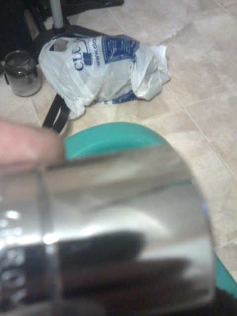

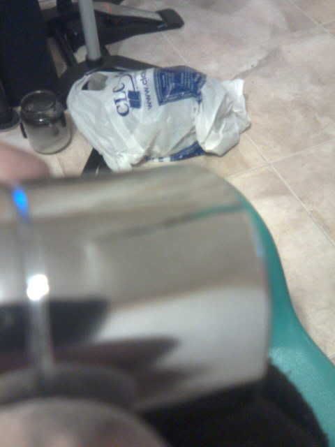

ok so i may just go for an impact gun now lol here is the aftermath of what happend to my socket. i used a long ass breaker bar and a 1/2 drive ratchet. always thought the ratchet would break before a socket

IJ.;1398680 said:
What brand was the socket?
bought it from pepboys. its not craftsman. my craftsman 12 pt. socket slightly stripped the bolt so i bought a 6 pt. socket. ive never had any of my sockets break this is the first
64
Couple of tips if you do try an impact, get an unplated socket and wear eye protection ;)
I don't think a good quality brand name socket would have broken like that using a cheater bar.
