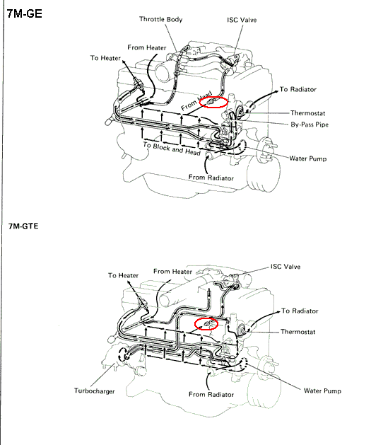

What seal are they referring to? I almost 90% sure i'm burning coolant as I smell it and the car smokes during idle, but after driving away its gone... So I'm thinking its some small leak possibly a crack somewhere causing this... I just did the HG too w/ ARPS, stock HG, Shaved head... I did the repair thoroughly basically or so I believe.
Another thing I found interesting was that this port differs from GE and GTE? on the GE head, that coolant port comes out of the head whereas the GTE it comes out of the block? I circled what I'm talking about in red below:
