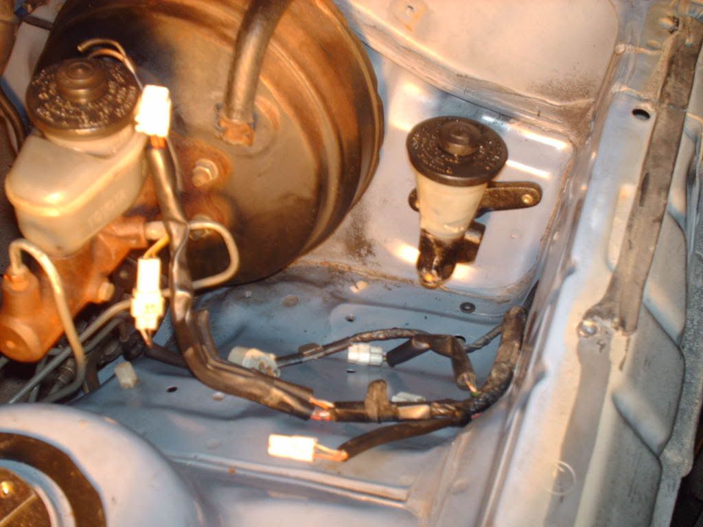

heres the master installed (No fluids or lines or tranny or engine yet)

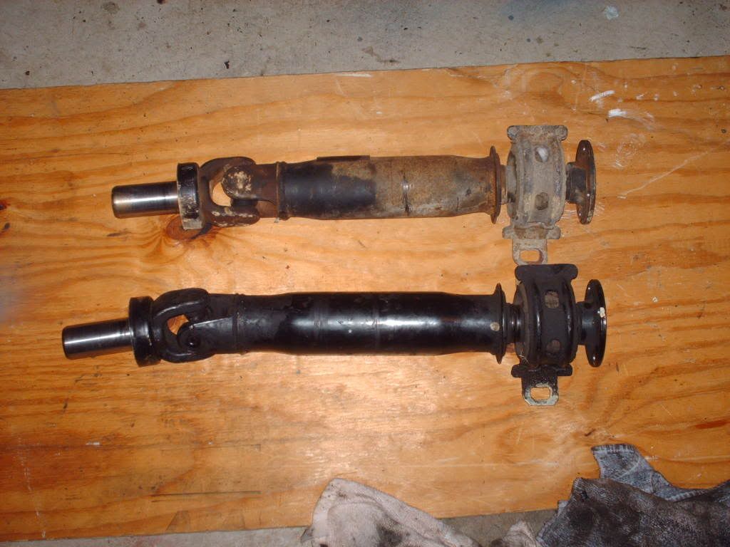

And the driveshaft

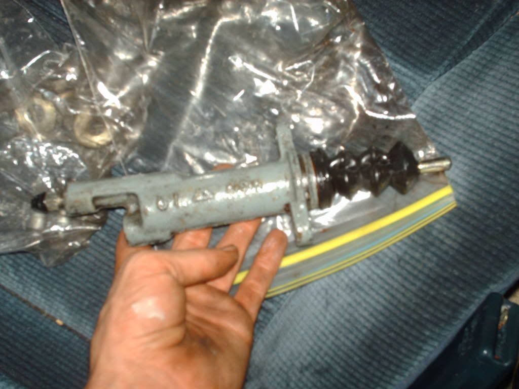

And the slave

The guy i bought the parts from had a bag labeled (Clutch) with the mounting bolts and a spring.
hmm
Maybe it was for the brake i know for a fact the brake pedal has a spring on it.

Wait, are all of our pedals like that?
EDIT: No they are not! There should be a ~3" gap between the top of the brake and gas and the same between the clutch and gas, you're doing it wrong
Well thats funny brakes have been tested and they are perfectly fine. and the clutch pedal is exactly where it should be. I mean the master has to bolt to the bracket. And if I need the spring why isnt it in the picture?
Oh i know why. I used the auto brake pedal bracket instead of the 5 speed. either way the brake and clutch work as they should.

You might want to fix that as it could give you trouble in the near future :naughty: " Give the car gas, Oh sh*t thats the break!"
