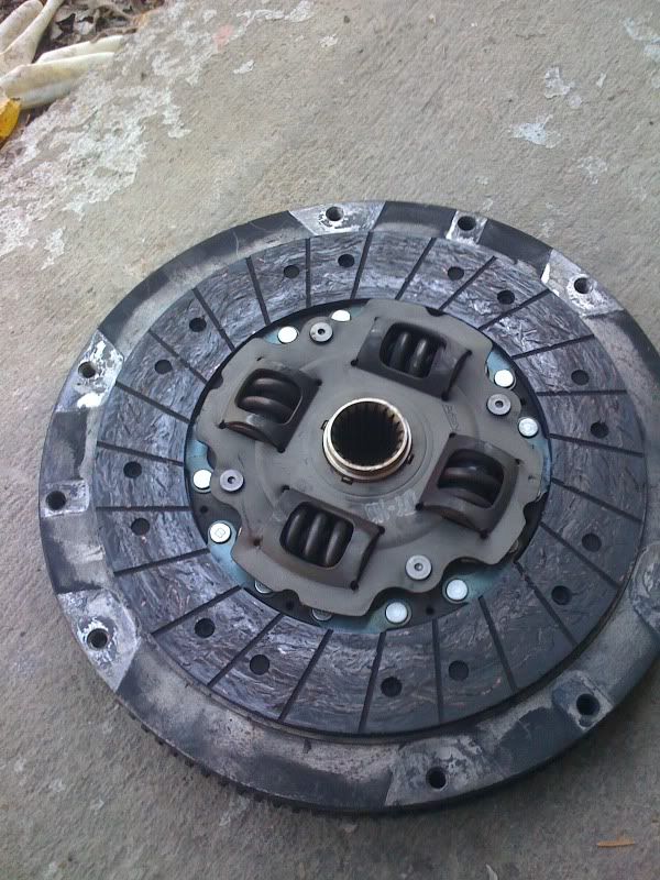

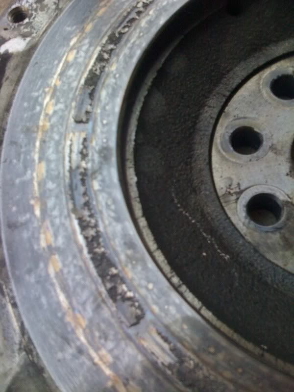

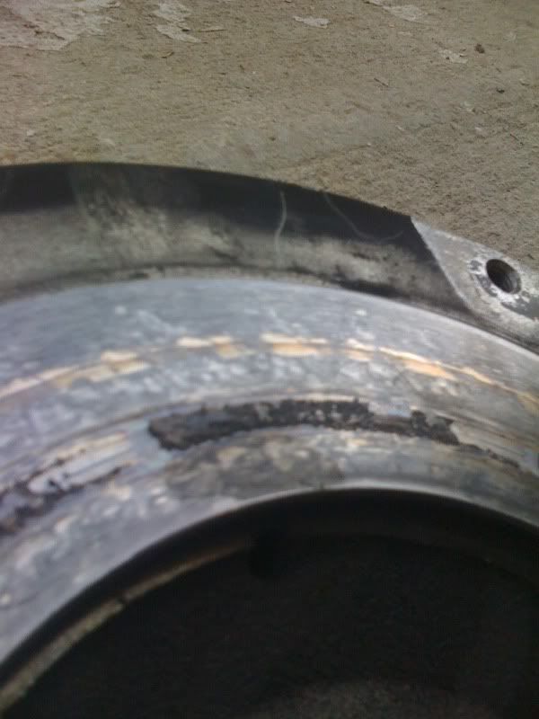

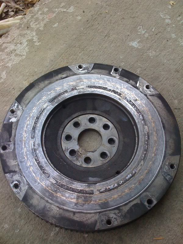

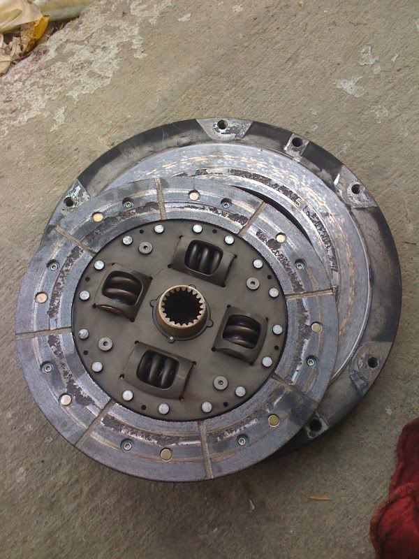

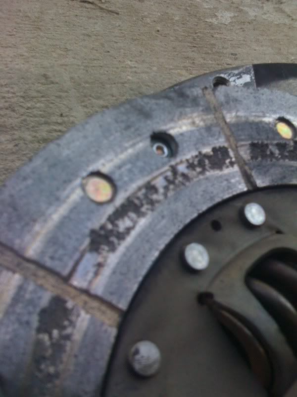

Well I took the advice and pulled the transmission out and I mailed it to South Bend for them to "repair/replace" the clutch and machine the flywheel. Free of charge, of course... (Besides shipping which wasn't bad)
Took me about 3 hrs or so to get it pulled but all in all, not as as bad as I was thinking!
Here's some pictures:
Back side of the clutch
Flywheel (Note the clutch material on the flywheel surface...)
Clutch disk
I'll update once I've got it back.
