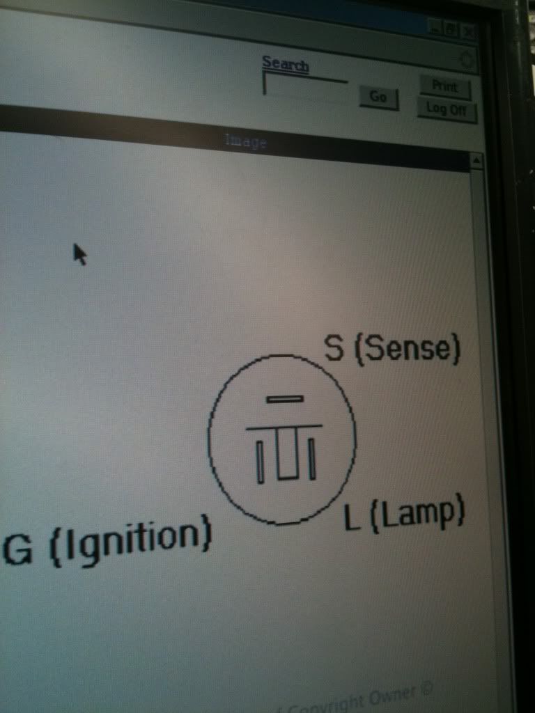

Heres the pinout for my 91 ls400 alternator.
89supra7mgte
Sep 20, 2009
797
colorado
OK that helps. not entirely sure which one it is still, but check all 3. The ignition should have bat voltage koeo. The sense wire might be the one that allows the alt to send power back to battery. and the lamp is well for the lamp switch on the dash, looks like battery. Does that light come on when you turn the key on? look in the tsrm for the correct testing procedures.
