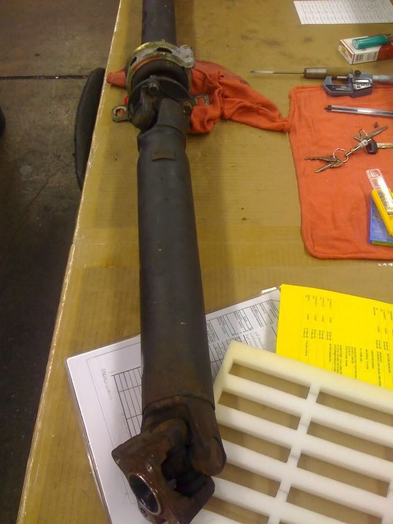

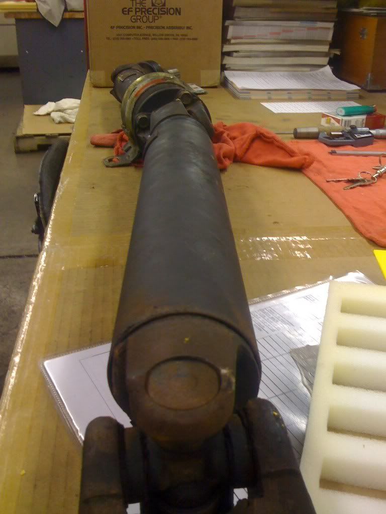

ok well obviously IJ was correct again....as always...
if you notice...the rear section of the driveshaft (has the end that bolts to the diff connected to it) is slightly cocked....considering that the 7mge is such a powerhouse a beast of a motor the driveshaft failed under such EXTREAM stress....lol
it should be a straight line from center of bearing to center of bearing..
but if you also notice:
my center support bearing looks like pure shit ....so inspect the driveshaft for all its possible flaws.....there are many!
[thumb]http://img.photobucket.com/albums/v39/canadianbacon/IMG_0262.jpg[/thumb]
[thumb]http://img.photobucket.com/albums/v39/canadianbacon/IMG_0263.jpg[/thumb]
[thumb]http://img.photobucket.com/albums/v39/canadianbacon/IMG_0265.jpg[/thumb]
[thumb]http://img.photobucket.com/albums/v39/canadianbacon/IMG_0266.jpg[/thumb]
