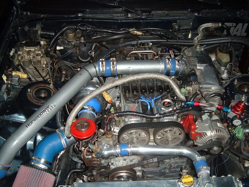

Alright before I get started on this idea I assume that I will get remarks about this idea being "rice" but i think it would be a interesting project.
The idea that i have is to make carbon fiber intercooler pipes or piping.
My idea for the first piece is to go from the throttle body and eliminate the 3000 pipe and have it extend to where the pipes go into the fender. As such but without the couplers:
(hope Supra8795 doesn't mind me using the picture)
The problems that I see with this project are:
  1. How to make the mold
  2. The temperatures within the hood ruining the epoxy
  3. Having the pipe be seamless so there is no chance of splitting under pressure

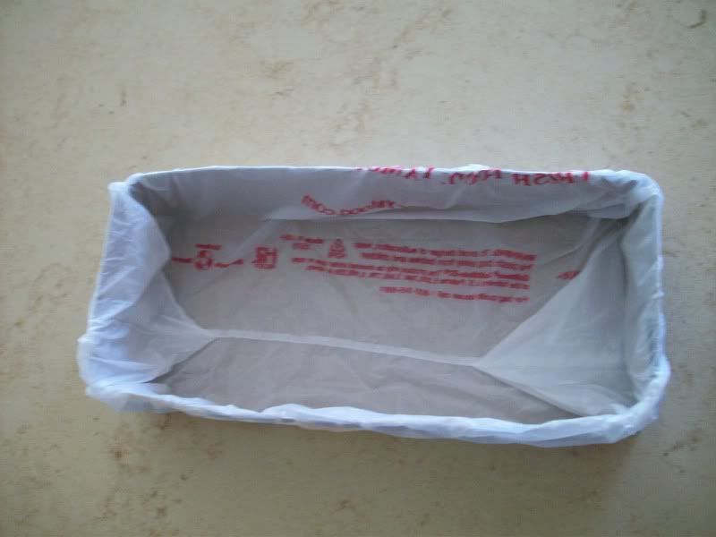

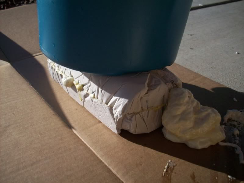

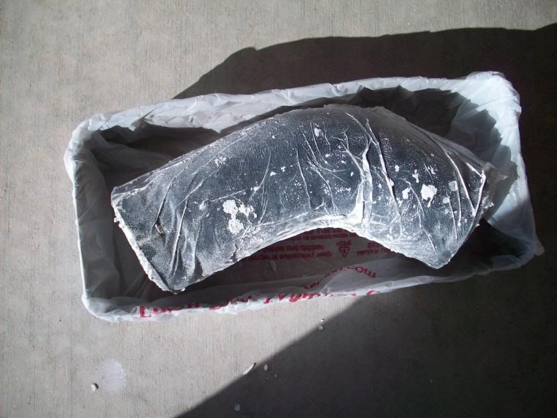

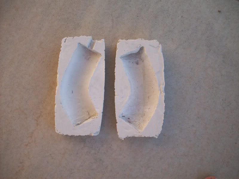

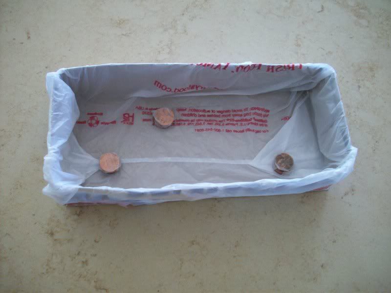

Ok well I did a plaster of paris mold of the elbow because the outer diameter is 2.5'' and its the right angle.
Heres the step by step pictures
Just waiting for the foam to cure and hopefully the oil that i sprayed on the molds will keep the foam from sticking
