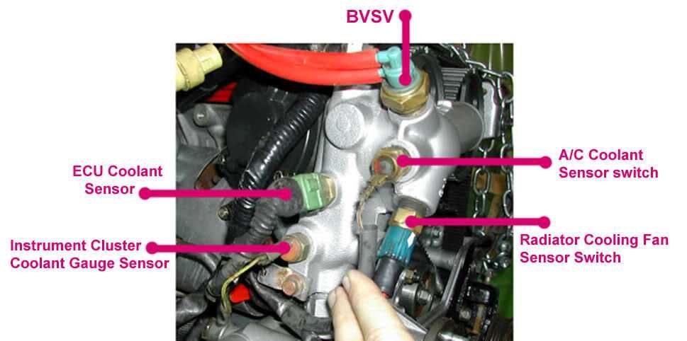

Ok so i looked at my car and the sensors and just wanted to correct myself on the water temp sensor issue. What I realized i ended up plugging in was the ECU coolant sensor.

Well, that's what I assumed you were talking about all along but it still doesn't matter. Unless there was some indirect correlation like bumping something or slamming the hood it had nothing to do with being able to crank the engine. It's as simple as that.
