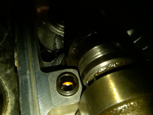

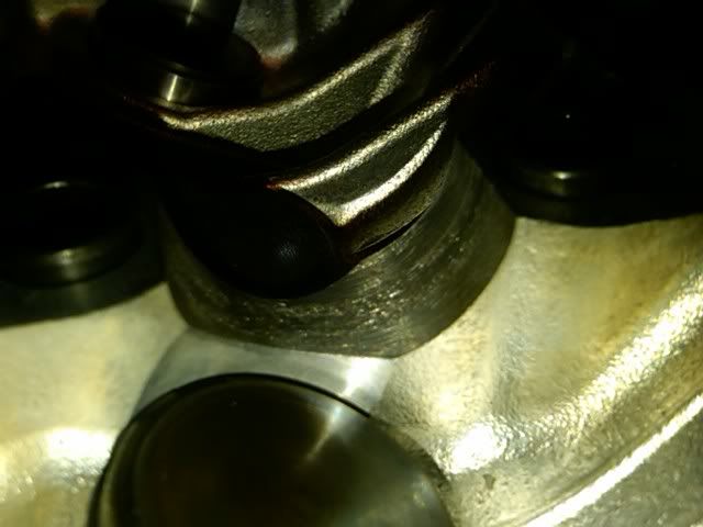

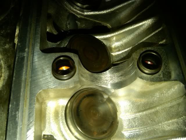

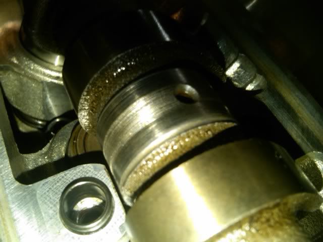

How the hell does this happen.
If anyone has a good intake cam for sale ans possibly exhaust depending on price, please, please PM me and let me know.
Other than that... Ideas?

It does but that's easy for most oil filters, especially if they're changed too often which is what most people do. The tip off would be compressor blade leading edge erosion like the kind typically seen with K & N air filters.

Still trying to get my head around how ingested dirt finds it's way to the Cam saddles though?

The oil filter could have gone into bypass but studies have shown full flow filters don't do much of anything anyway. It's what makes the huge marketing behind them so amusing. A good air filter is far more important to the engine's health. That's my story and I'm sticking to it ;)
64
LMAO I can see upper cylinder wear being an issue with bad air filters and I guess in time you could end up with enough wear that some crap would get by the rings into the crankcase then into the oiling system, I'd hope even the worst filter would catch the majority of this garbage.
Another scenario that comes to mind is a dirty assembly but I don't know this engines history.
(Filters take a LOT of crap before they'll bypass and being a 7M I'd sort of expect RK long before now)

Yeah, I think the typical bypass setting on most filters for this engine is around 16 psid. And you're right, the cause behind his problem is all speculation without knowing more. Iirc the saddle material is pretty soft although I don't recall if it's babbitted. Been too long ;)
64
Babbit is on the Journals, saddles are plain Al, another possible contributing factor will be an annealed head on the Ex side, be interesting to see the intake side for comparison.

I was also thinking.. this is probably not the case, but if someone with a BHG kept running their car, wouldn't the oil lose its lubricating ability.. and you might have metal to metal contact?

Could be a factor that the gouges suggets it's had debris run through the cam saddles (it get's trapped in the soft babbit material on the cam journals and just gouges away till there's enough wear to escape)
Have to wonder at the Mains and Rod bearings at this stage.
