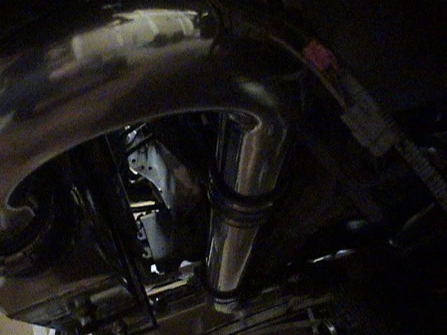

what kinda exhaust are you running?
3" ss ct26 replacement elbo, megan dp w/ 3" homemade catless exaust and egay muffler:wuteva:
would have liked to get somthing nicer for the cat-back like the blitz nur but, I couldn't bring myself to fork over that kind of cash right now.

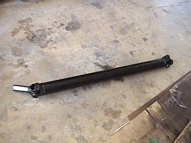

Hi Moe, it's cool to meet all you guys/girls. Yeah chico is about 1 1/2 hours north of sac. I actually met Jeff @ jawsgear when I picked up my D/L a couple months ago.
I wanted the aluminum shaft but he didn't have one made up so I had to settle for steel. I saw a black supra there and it looked so bad ass with the fat ass slicks. I parked mine around the corner cause it would've looked like shit sittin' next to that beast.

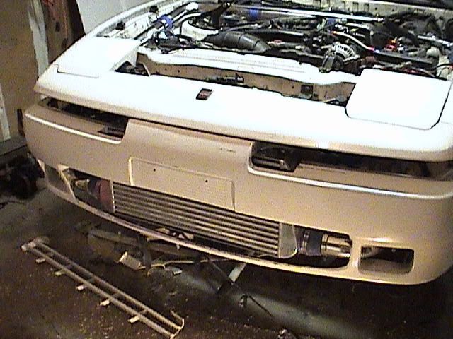

By the way Slo...what bumper is that? I thought I saw a similar car for sale on Craigslist...maybe I am wrong but that bumer look familiar. Did you do a whole turbo 7mgte wap or just threw a turbo on the 7mge?

The bumper is stock. I just cut it all to hell to make room for the massive ic. In the near future I want to re-mount the ic back a little, and down ~2" or so. Notice I had to cut on the top around the grill inserts. I didn't have a problem with it at first, but now its starting to look shittier every time I look at it. I originally mounted it like that cuz if I would have mounted it to fit under the top part of the bumper cover, the bottom of the ic would've been hanging below the bumper cover. Kinda like weezl's car used to be. Looking back at it now, the problem could've been solved w/ a front lip, but oh well.

all that intercooler hiding behind the bumper wont get n e air... alittle bit of an overkill man
An upgrade, nonetheless. No such thing as overkill when it comes to intercoolers. If it fits, take advantage of it. It's much better than the factory shitercooler.
Very nice looking though, man. Welcome to Supramania.

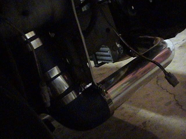

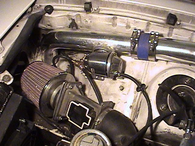

SLO_MK3 - With an intercooler with side to side inlet/outlets, how did you route your pipes?

Thanks for the complement boost. No such thing as overkill on the IC were my thoughts exactly. especially compared to the restrictive bottle-nose stock set-up running 14psi.
here's some pics of the pipes

sorry did not mean to offend anyone but more intercooler is not always better properly fit to your needs... like amount of boost going to be run, bpower goals that you want achieve .... more intercooler for a smaller turbo means excessive lag and tests show when there is no air getting to parts of intercoolers it lets warm air get passed as well as the cooled air... but hey wutever floats your boat! it does look sexy tho!!! you should paint some teeth on it!!! HAHA
