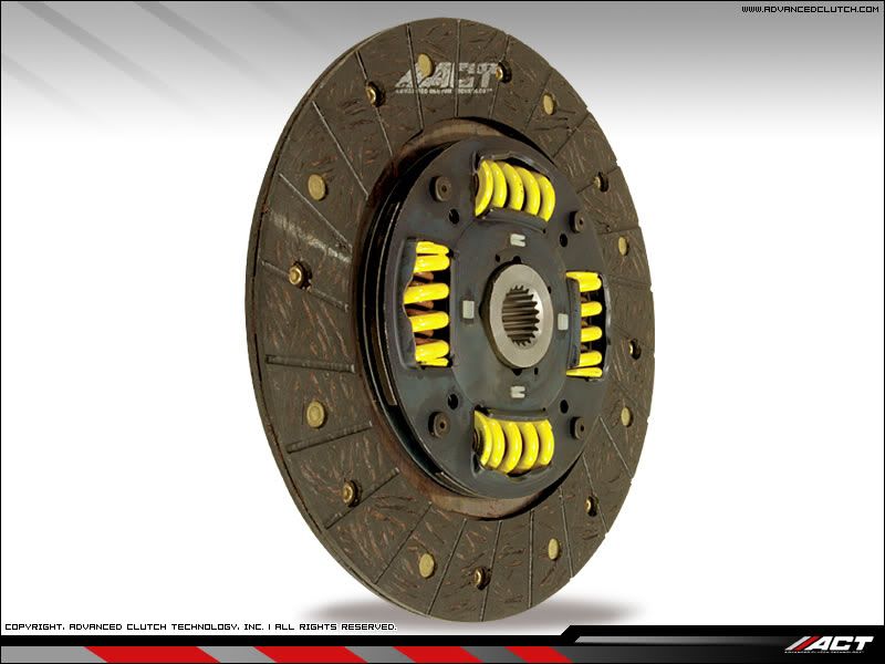

Question for you tho. Is your engagement COMPLETELY smooth or is there a little bit of chatter?
Mine has a slight chatter.

CajunKenny;1573065 said:
I did. Not only does it save the components you mentioned, it also saves the thrust washer in the transmission. Question for you tho. Is your engagement COMPLETELY smooth or is there a little bit of chatter? Mine has a slight chatter.
You have the organic sprung street disc, right? Machined flywheel? Mine was 100% smooth from day 1 and still is. I was very careful to follow the 500 mile break-in period with soft regular driving only.

Does the Disc have Marcel washers/springs between each friction surface?
During cold start with rpm's ~1k engagement is completely smooth. Op temp with 650 rpm, chatter.
Organic sprung street disc: Yes.
Machined Flywheel: Fidanza with a brand new insert
Break in: Proper Gingerly Driving for a full ~600+ miles
Nope. I don't remember seeing that at all. You, Brad...?
63
It will chatter then there's no way around that other than more rpm/slip Kenny.
(Marcel's only reason to exist is to cushion the initial engagement to stop chatter but they're a fail point for high HP so are often deleted)
Not the best view; but, here's my disc:
Well, fooey then! I want it smooth like Brad's! :)
