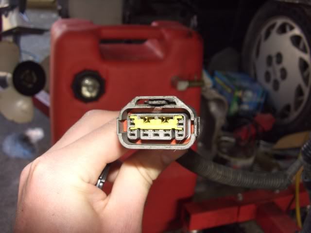

I did a lot of searching and couldn't find a direct answer. Here's my situation...I put a soarer 1jz with the A/T ECU in my 1991 turbo with the R154. Everything is wired right (odom helped me and he did the same wires and his is running).
The car is getting power and everything. But, when i turn the key I get nothing. How exactly do I bypass the neutral start switch (jumper which wire to which wire). Please help me. It's killing me. Thanks guys.

oh, ok. you will see a big, round 3-wire plug near the starter that has some thick gauge wires.
jump the blue and the white wire I believe.
Ken
Apr 6, 2005
350
Houston, TX
that is the plug that goes to the NSW of the automatic trans. jumping the two wires simply closes the NSW circuit, allowing you to start the car. with the key.
you asked how to bypass it, there you go.
I can't seem to find it. I am using the R154, not the auto. Is it plugged into anything or just sitting there loose since I'm not using an Auto?
AF1JZ
Almost civilian status...
Jun 26, 2006
3,109
Fredericksburg, VA
Well, I got that problem fixed. It was a black and black/white wire that I had to connect. So, the car cranks now. But, my fuel pump isn't getting any power. Now I'm stuck trying to get power to that.
