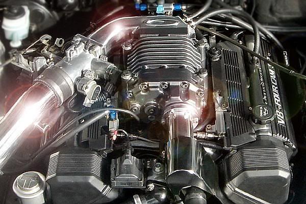

Hey did you used to live in Tn? if not theres a car in knoxville that looks just like yours. oh and i like the supercharger idea, like this!
