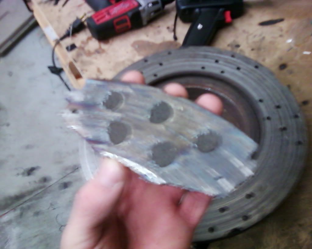

this is what happens when the piston in your caliper wont retract....BAD THINGS!
