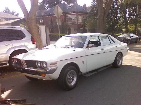

Where it is now, the Corona is basically a big mess. The fuel pumps setup is garbage, and the engine wiring harness is a catastrophe. I was getting impatient to have it all done back then and started trying to get away with shortcuts. Now I will pay for that by having to re-do it all. I don't mind anymore though, because my long term time constraints no longer apply. I still have a vision for this car, and I want it to represent my standards of work. The goal is to have a bad ass old school Japanese car that I can be proud of, and say "I did that".
Here is a picture of the Corona about to be put on the flat bed and taken away:

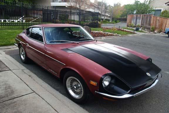

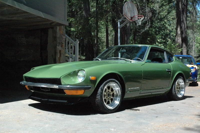

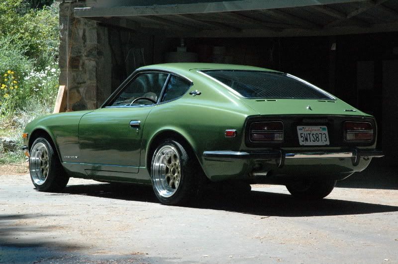

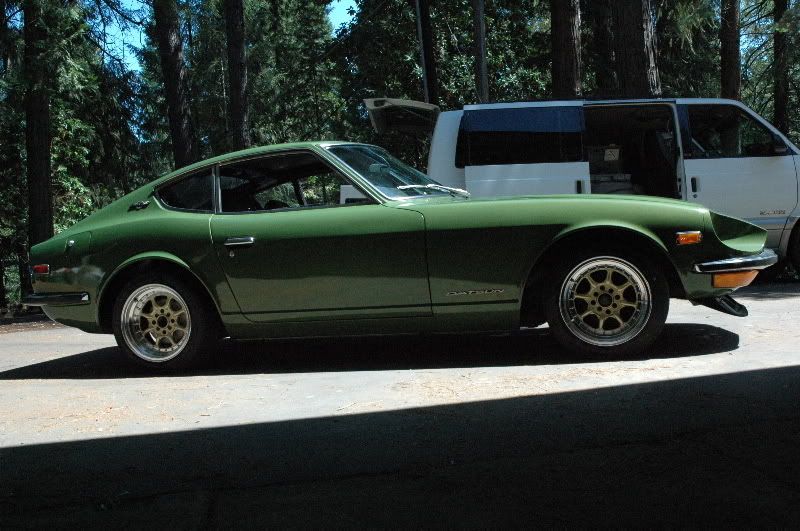

In the mean time, here are a few photos of the Z.
Went from this:
To this:
