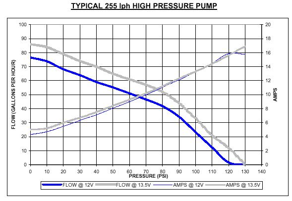

I see, well that would be the one to go with i guess, being rated at 100 amps (continuous?)
Found a good pdf on bosch pumps and flowrates: http://www.lucasinjection.com/_borders/fuelpumps.pdf
Looks like the 413 pump (last on list) is even bigger then the 044 flowing the same 200l/h but at 8 bar pressure.
Hmmm... according to this graph of a walbro 255 high pressure pump, at 5 bar flows between 45 and 55 gph. The Bosch 044 flows 52.84gph at 5 baraccording to the pdf, Does this mean a walbro flows as much as a bosch 044? I read on that website posted that those figures are using a different liquid then gasoline but still makes me wonder.
