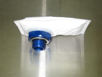

If you could get it in the hole one of these would work>>
64
AndyMac;1366400 said:
hey thats cool!
makes the 044 an intank pump!
I will hopefully be finishing my 040 install this weekend so I will be sure to share pictures.
