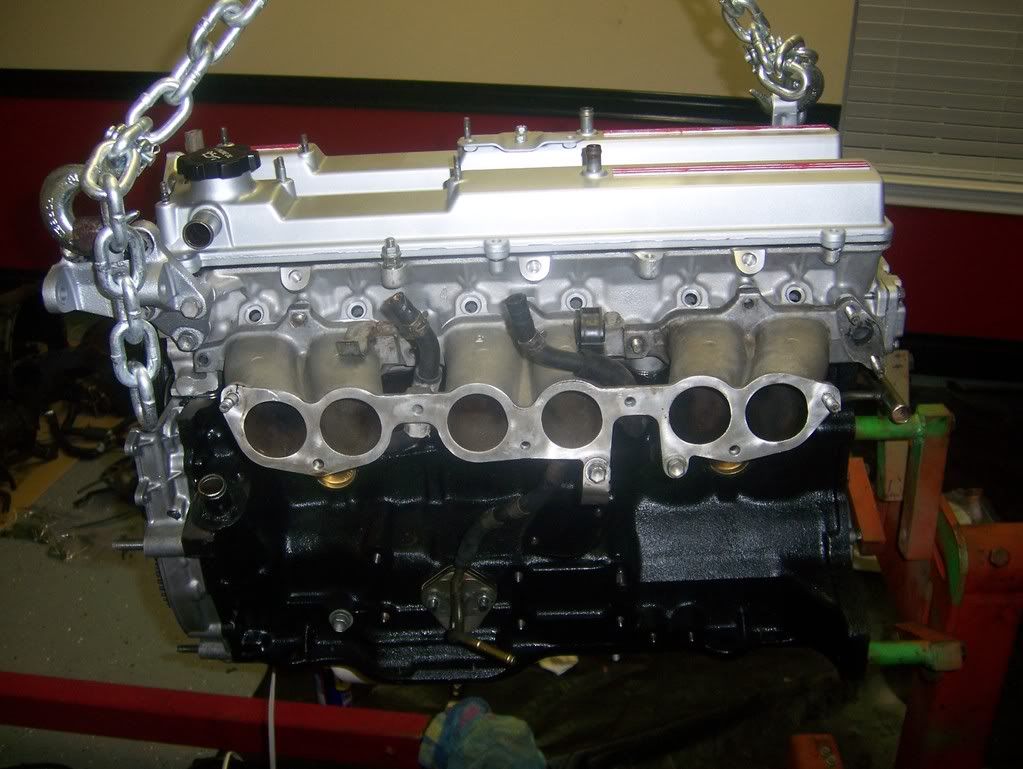

Head and a few other things got installed today! Broke a damn bolt on the oil pump strainer into the block when I was torquing it to toyota spec. Gotta figure out how I am going to extract it... So no oil pan yet... :3d_frown:

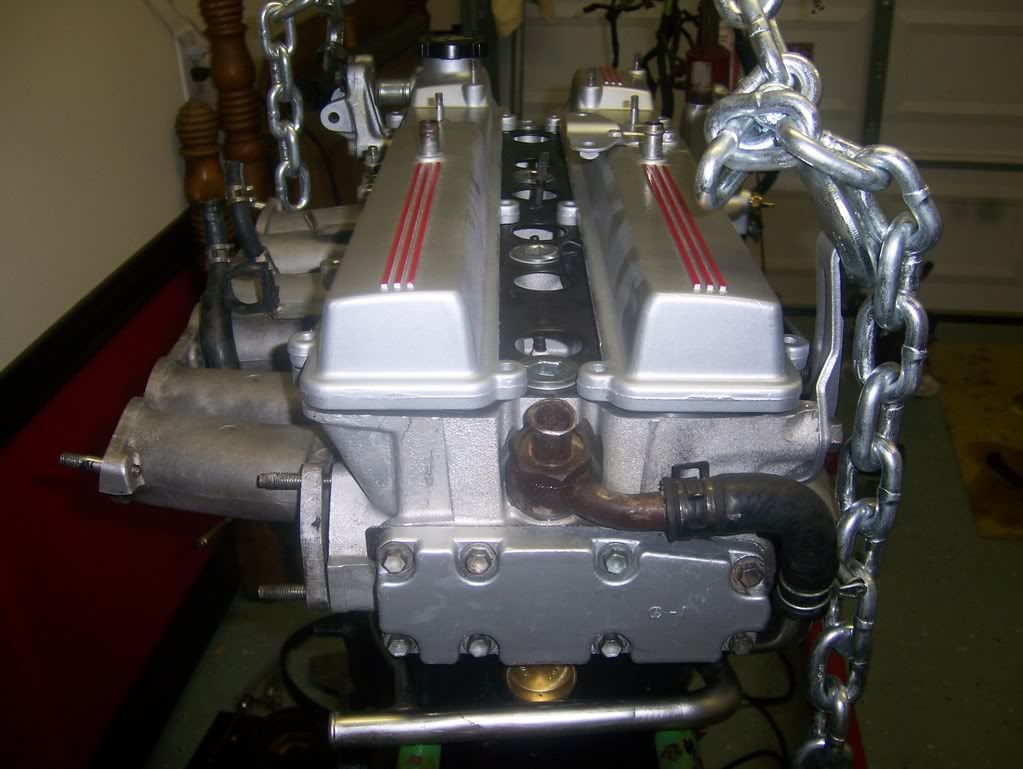

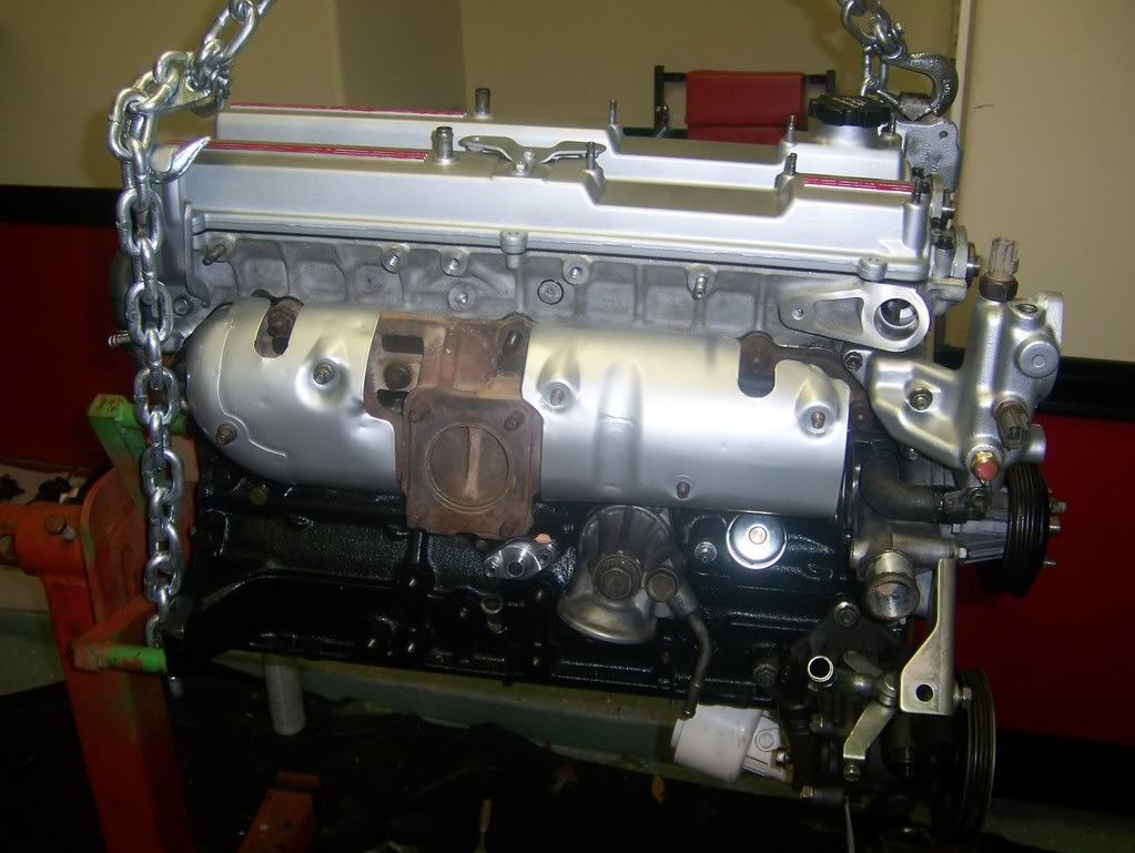

Got a few good things done today. I was missing some exhaust manifold studs from this head so I extracted two exhaust studs from my spare head!
On a more serious note. I stressing out big time over this broken bolt in my oil pan.

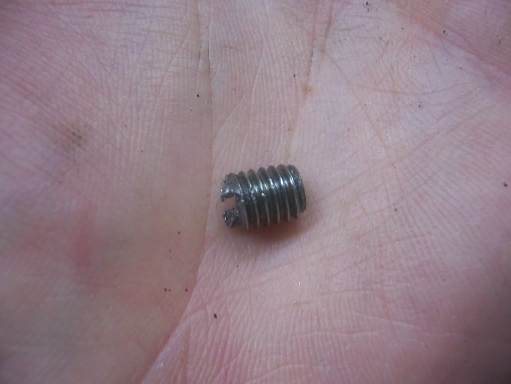

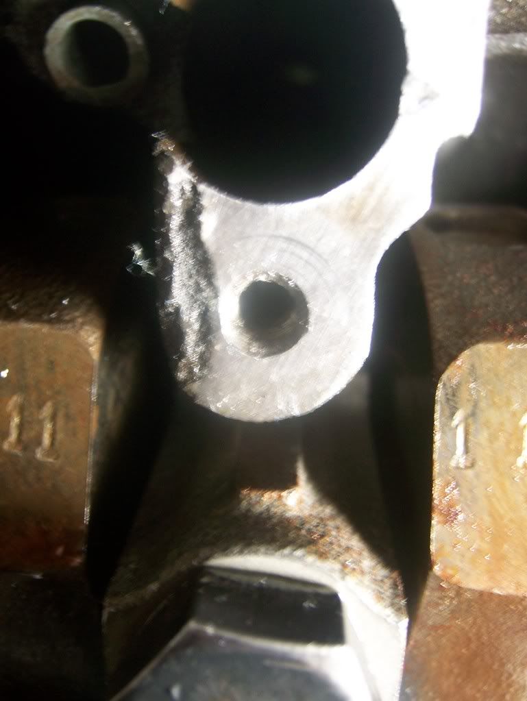

So the guy that was going to extract my broken oil strainer bracket bolt didn't show up tonight so I said FUCK IT. I got the drill out and with lot of coaxing and talking to the engine, drilling, patience, threatening the engine by telling it, it was going to the junk yard and more drilling and sweat and very un-comfortable positions.... I got it out. I am so thrilled!
Here's the lil bugger...
The hole... Threads are fine. I found a same size bolt and hand threaded it in and out several times with ease.

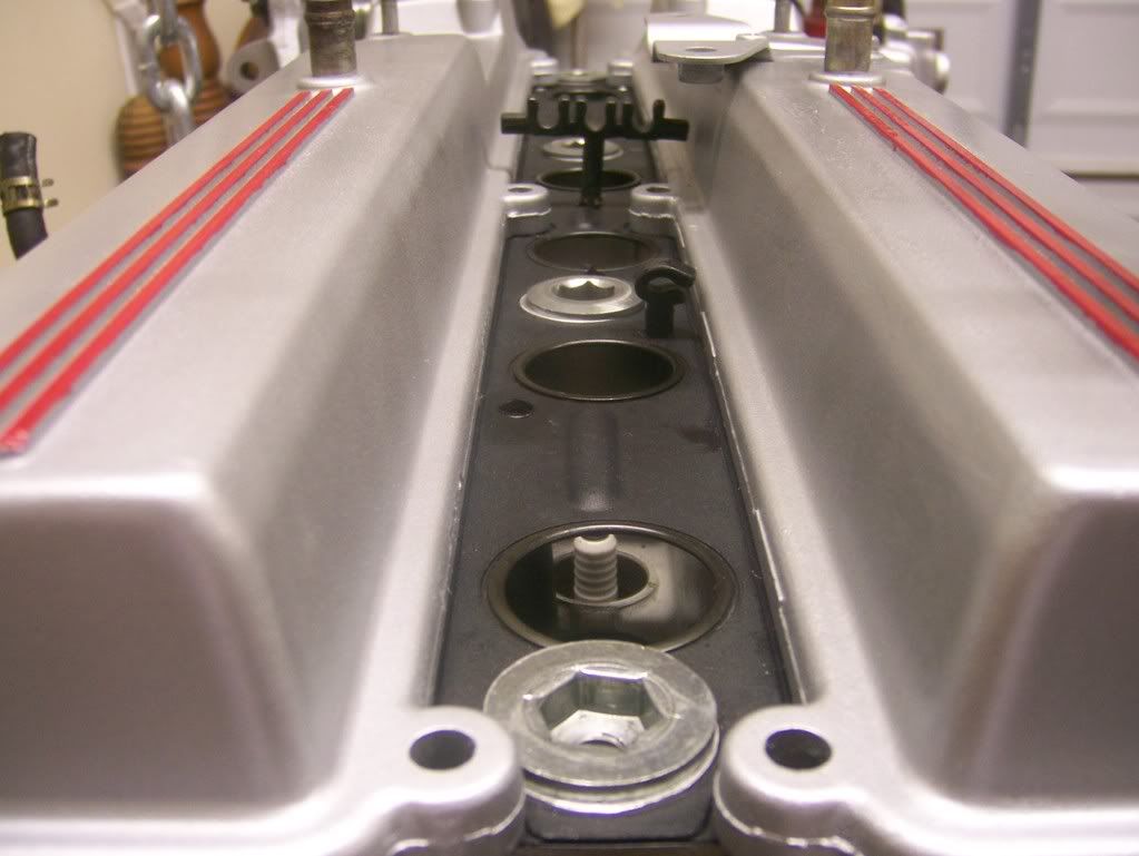

After that I kissed the engine and took pictures of her sexiness! Work starts back up tomorrow!
