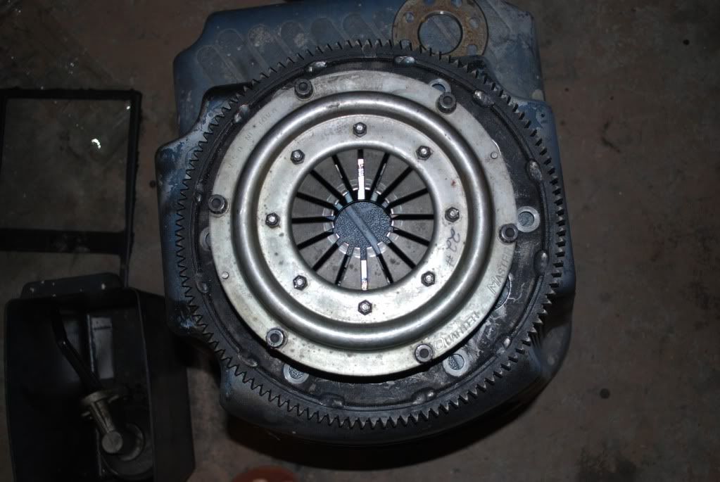

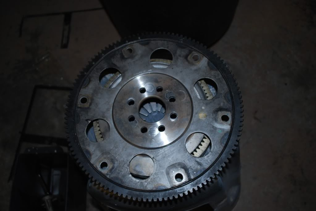

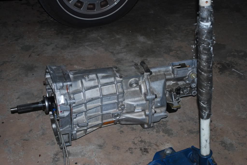

picked up the tilton and the input shaft today
instead of just redrilling the bolt pattern in the flywheel, my machinist cut plugs, welded them in, machined the back flat, and then drilled the bolt pattern in, those guys are awesome. still need to get the flexplate welded on and the FW balanced though.
they also machined the snout of the viper input shaft down shorter and to the diameter that i need for the pilot in the crank, i took a pic but the angle is wrong and you cant see the machining

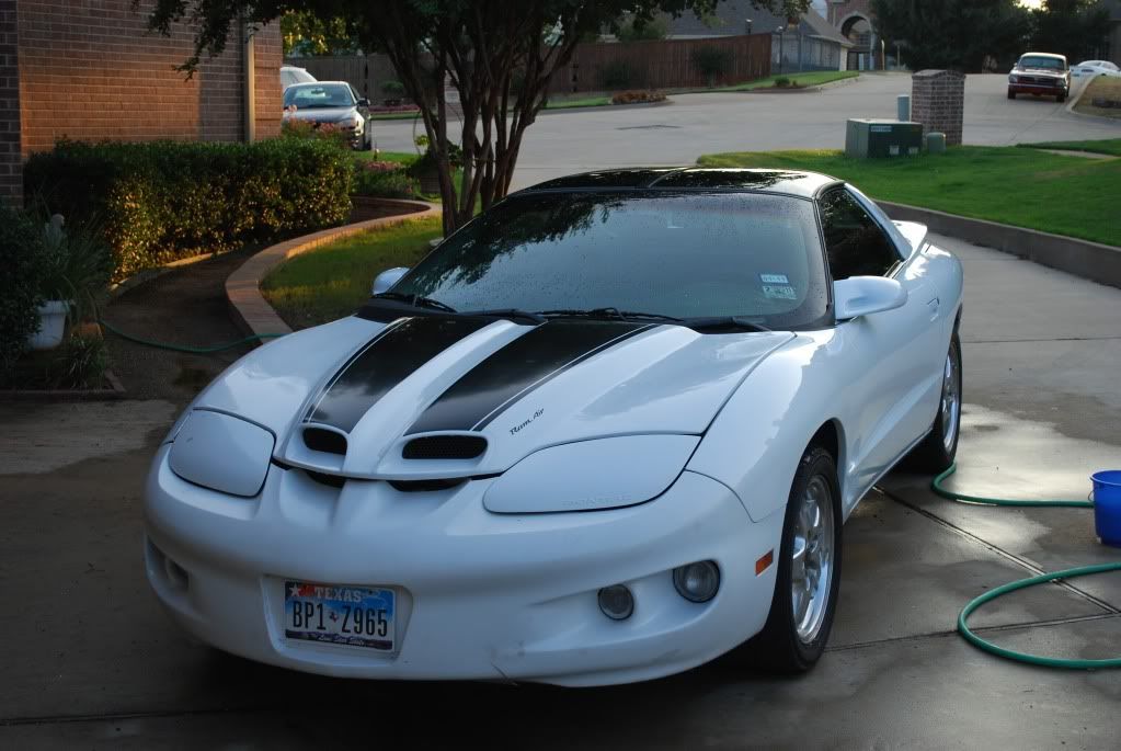

also picked up a new daily this past week, was originally looking at TE72's SS Camaro, but my dad said i could not for any reason other than dire necessity work on it, so i had to look for something not needing work.
got this, 1998 Formula Firebird WS6 - 1 of 221 made in 98
Rebuilt motor
Built auto w/ 3200 Stall
Motive 3.73's out back

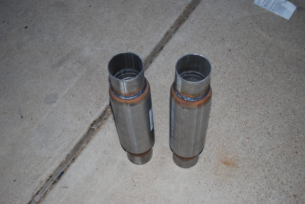

Headers w/ True duals
LS6 Intake manifold
its setup for drag right now and it pulls pretty good, i need to change the tune in the ecu, its eating through gas right now.

getting true duals put on it monday :)

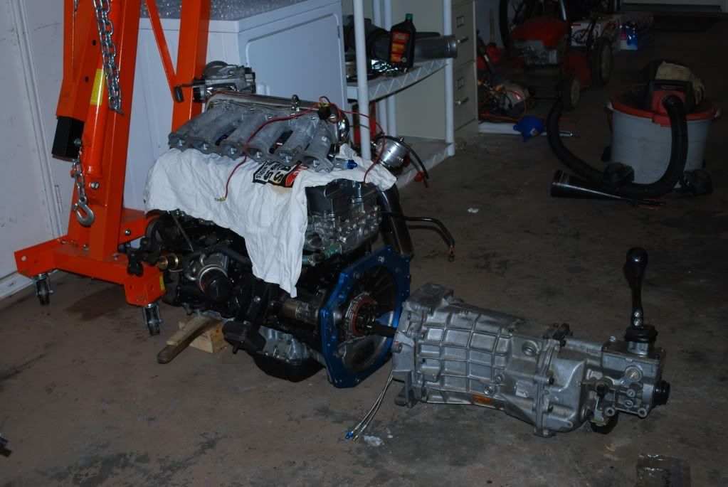

got the formula back together and running, so its time to get back to the supra

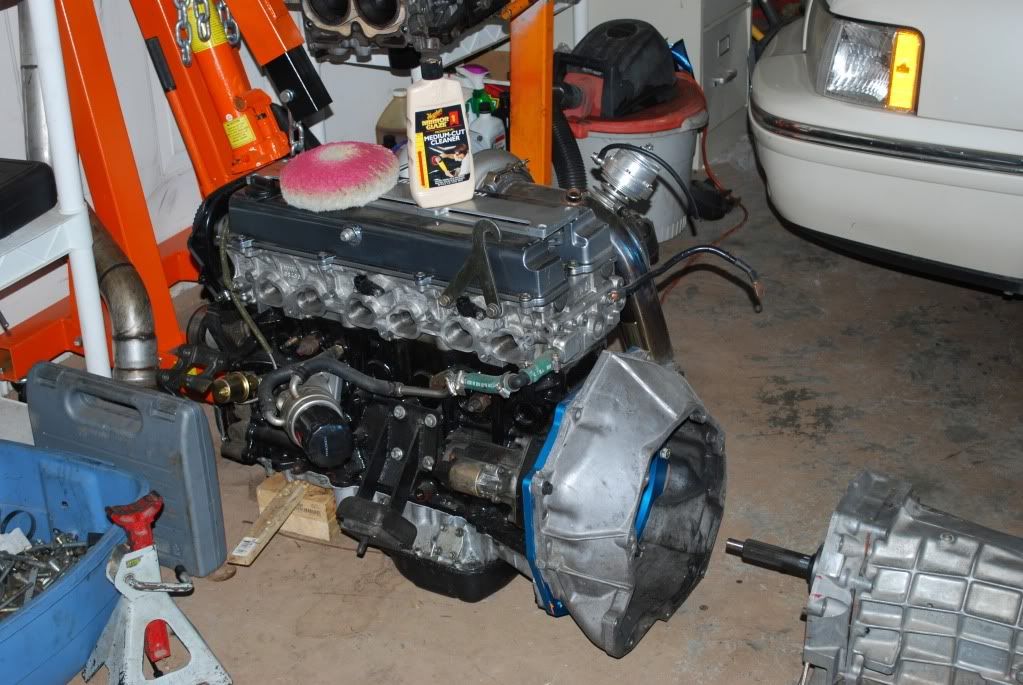

pulled the motor back out to start mounting the clutch and trans

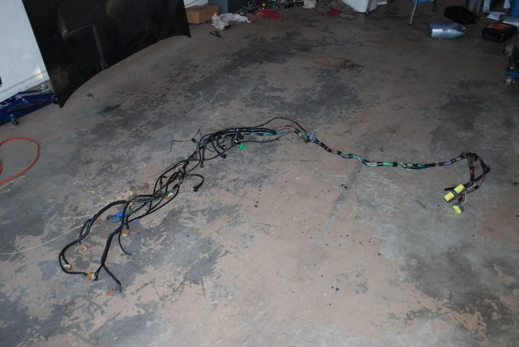

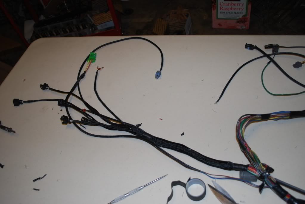

got the harness out of the back seat, need to re-loom it

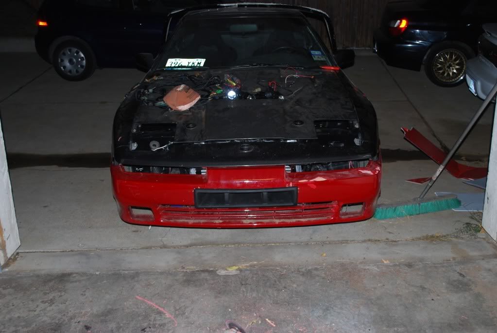

got some work done today, been sick most of the weekend
got most of the front end bolted on instead of just hanging there
started to re-loom the harness with braided loom instead of the plastic tubing

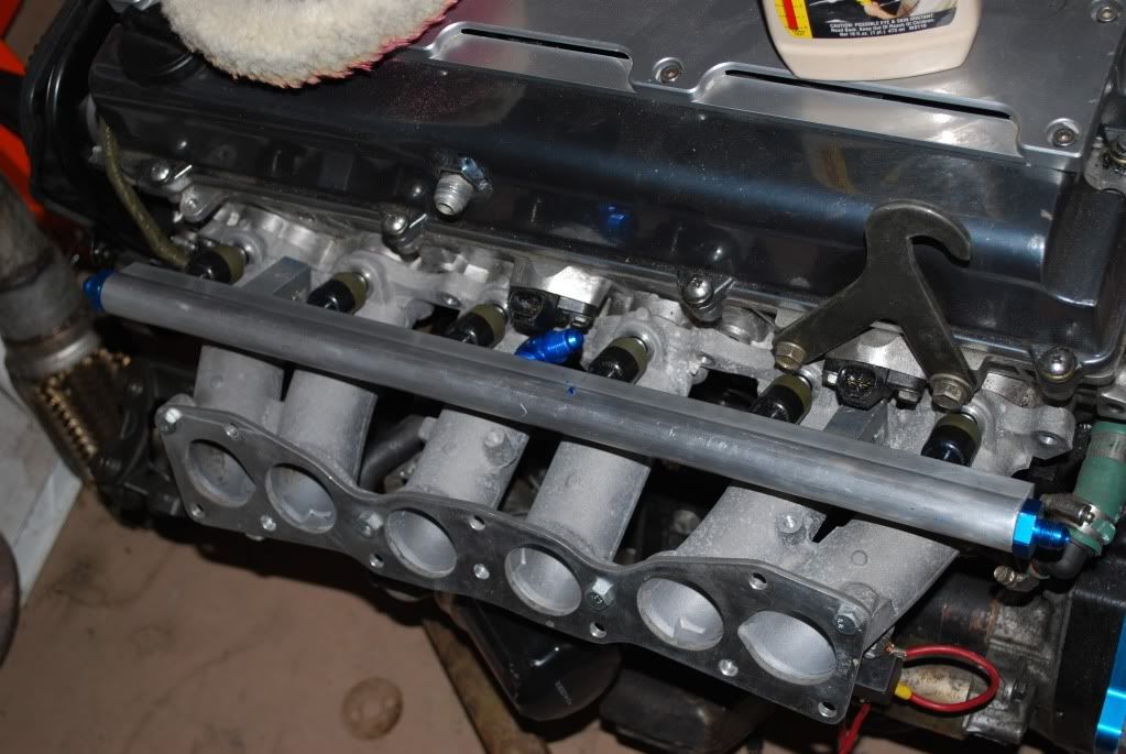

re-drilled for the stands on the fuel rail (1J rail on a 2J lower manifold)
engine and trans waiting on just a couple pieces more to put together

im going to have some work done to it to match the 1JZ head bolt pattern. which means modifying 4 of the bolt holes on the manifold.
but it lets me run the greddy 2J plenum

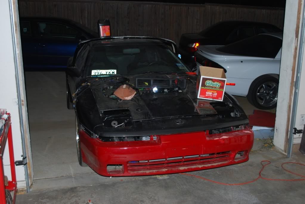

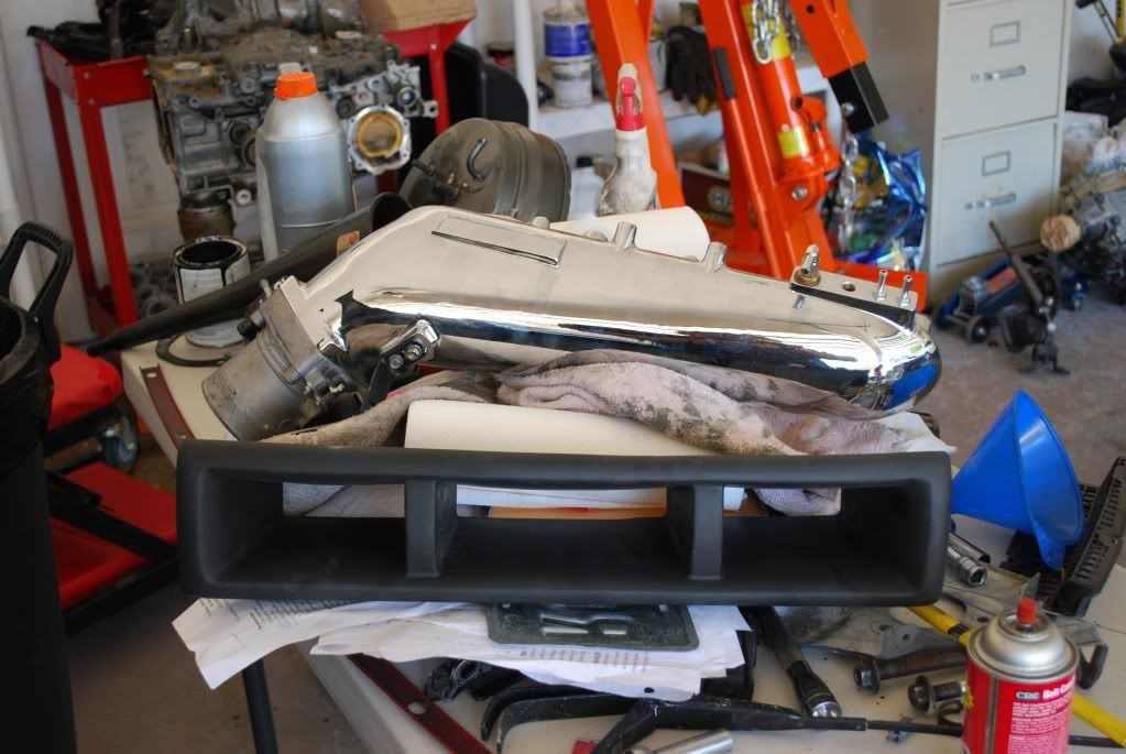

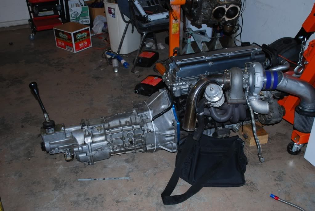

felt alright today, so did some work on the car.
got a 1/4" spacer plate (input shaft was 1/8th" too long) for the T56 from Quicktime Performance. now it all fits up nicely, just a lil more work to be done on the clutch and its ready to go in the car to get the crossmember fabbed up
put my turbo a duct in...........didnt realize until i put the bumper on that i mounted it about 1/4" too low, so gonna redo that tomorrow
