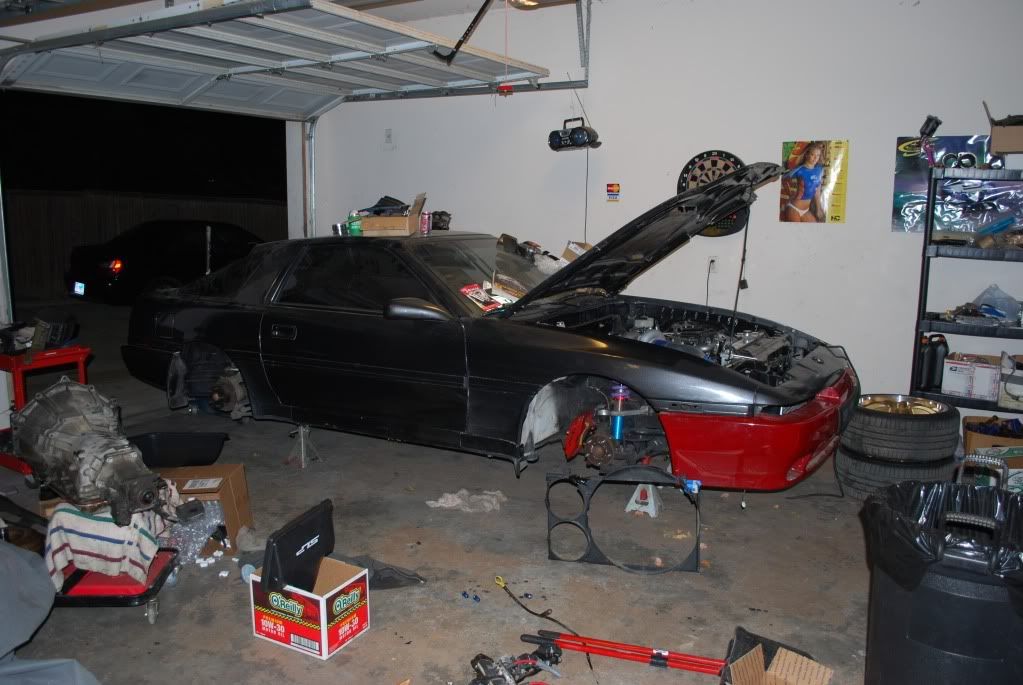

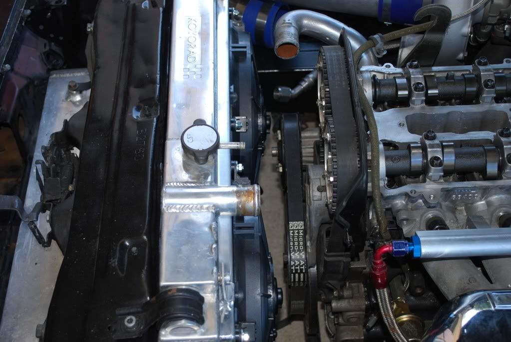

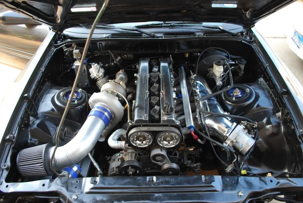

got some more work done, re-mounted the turbo-a duct to where it should have been the first time
mounted the clutch just to see it on the motor, lol
set the motor back in to the engine bay to start working in there

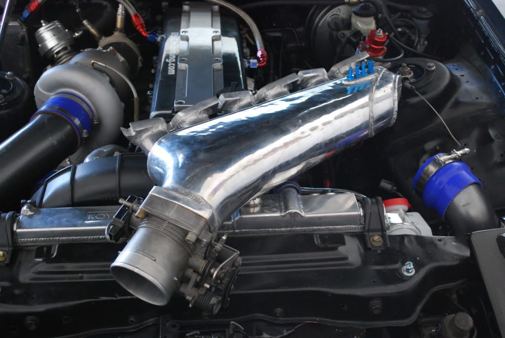

Hey do you happen to have pics of how the intake manifold needed to be modified to clear the booster. I believe we spoke a while back about this with the 1jz greddy manifolds and you mentioned they had clearance issues. Anyway I am looking at picking one up soon for my 1.5j
Thanks In advance
Thanks In advance
BJ
This manifold doesnt have to be clearanced for the brake booster. I changed over to the truck brake booster (doesnt stick out as far) while some guys have said this would hurt my braking, Im non-abs and have 13" 4-piston BBKs all the way around, so it wont hurt that much. i can give you pictures of the other manifold and how i had to modify the back of that one if you want

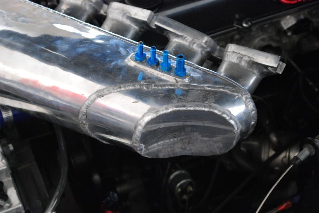

heres pics from when i sold that manifold
Bigzavs
86.5 1JZ Single Turbo
Apr 21, 2005
2,267
Arlington, TX
BJ91T;1630657 said:
Sweet! Looks like it would not be to involved for a skilled welder. Thanks again for the pics
nah, shouldnt hard at all

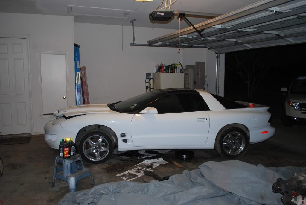

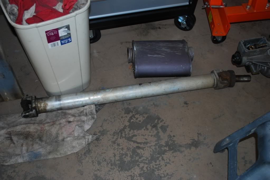

while pulling the 3200 stall off of the formula, i decided to put the steel driveshaft i was going to use on the supra, onto the formula, and use the aluminum shaft on the supra

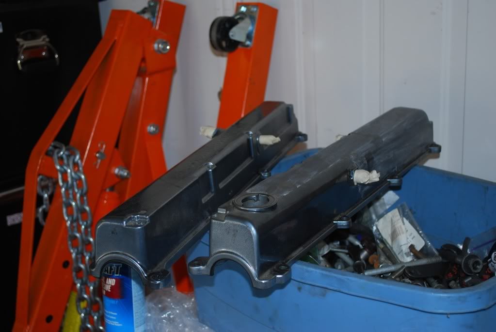

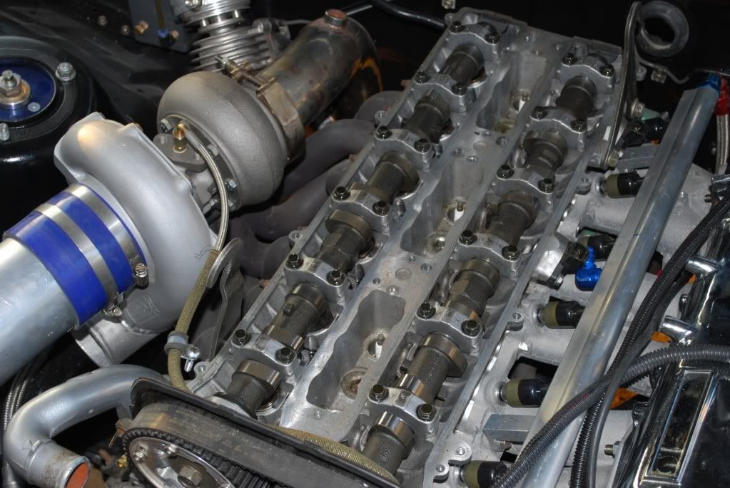

also, going to re-do the valve covers on the motor

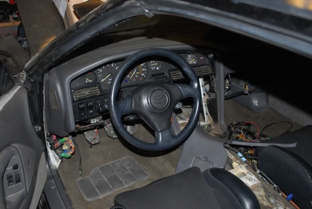

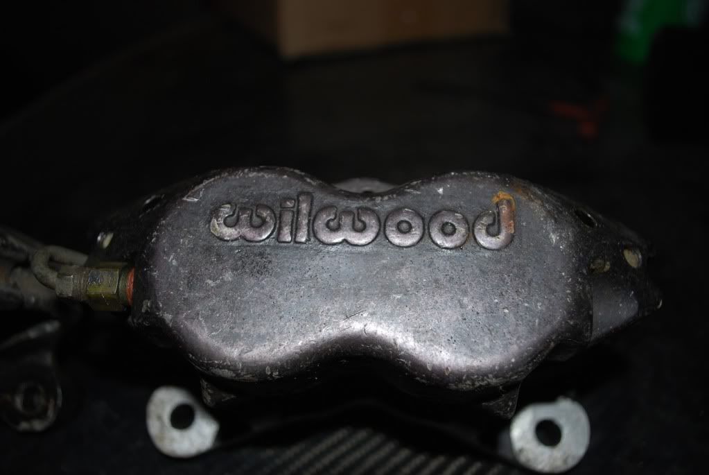

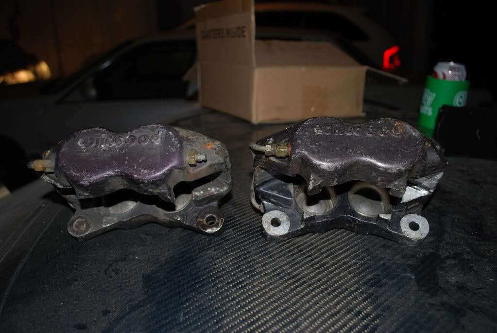

got a couple things today for the car
pair of wilwood dynalite 4-piston calipers (dirty, but were recently rebuilt)

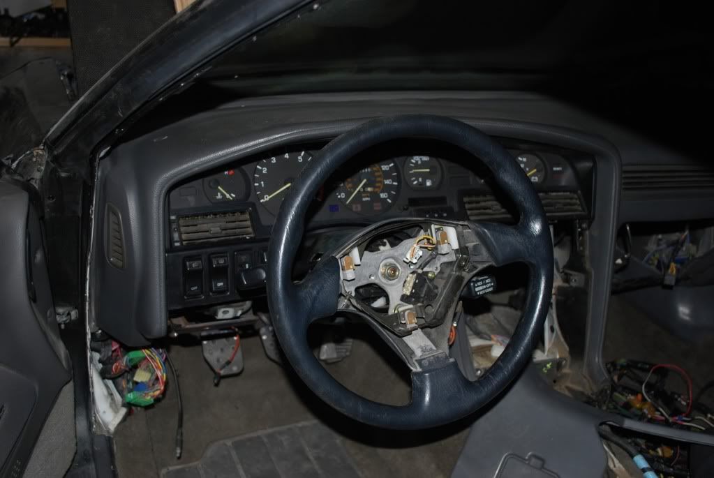

and a celica steering wheel, looks alot like the stock 98 mkiv wheel (i dont have the center yet)

honestabe;1632538 said:
I couple good coats of caliper paint will make those calipers look really nice. Looks good man!
yup, gonna do em up to match the fronts
got the center piece from a 99 celica, the 99 and 01 have different materials, so im gonna go back out and get the wheel from the 99 to match it, probably put the wheel up for sale on here
got my formula back together last night, front pump went out on the trans, so that was whole bunches of fun

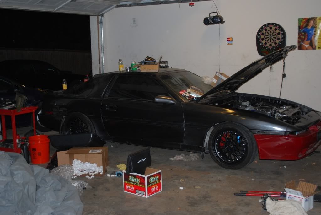

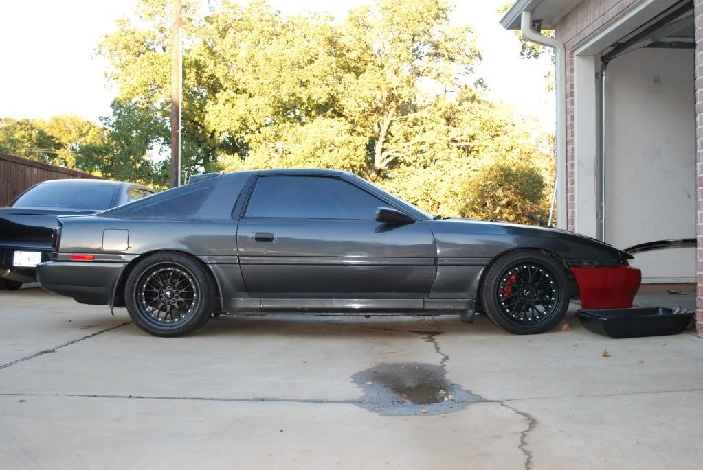

supra up on stands waiting on the new wheels
new wheels on it, front looks a lil odd, cuz of the red bumper (i really need to paint it now)

heres a better pic of the wheels on the car

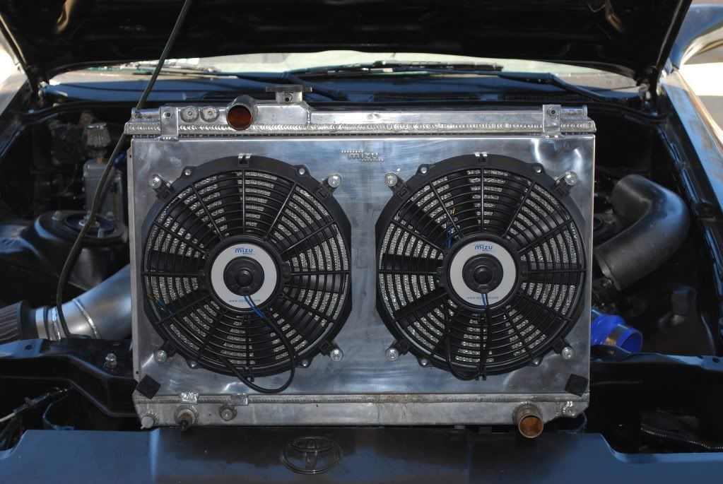

got the e-fans this week, i know the clutch fan works better, but the car is not a daily, so i think i can afford to run e-fans

decided to re-do the valve covers on the car as well, probably going to go with flat black
