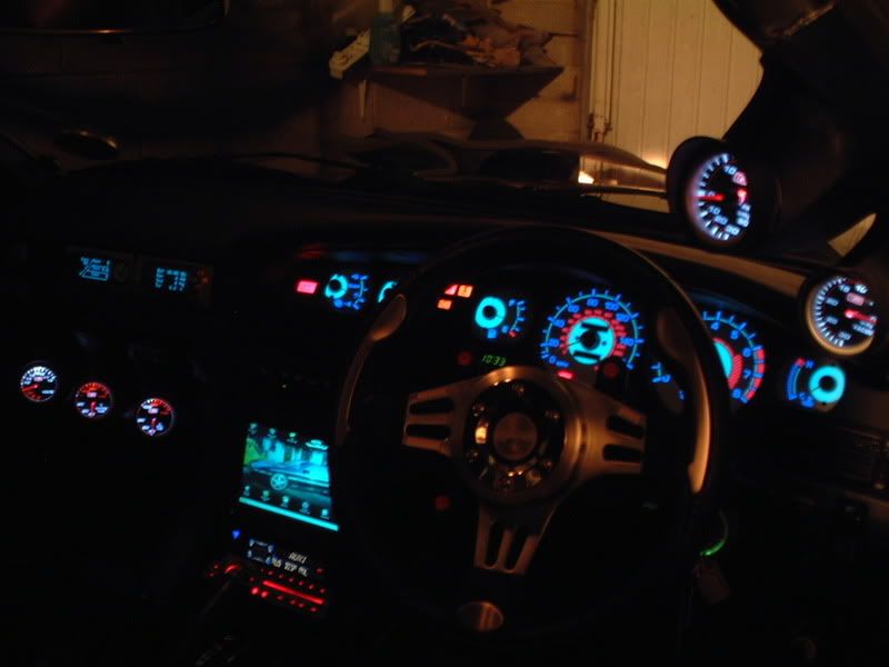

My handiwork. Only tools used were a regular sized Phillips screw driver, mini screw driver, and mini Phillips screw driver.
