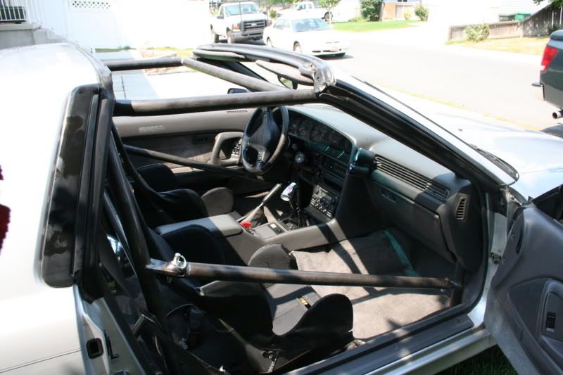

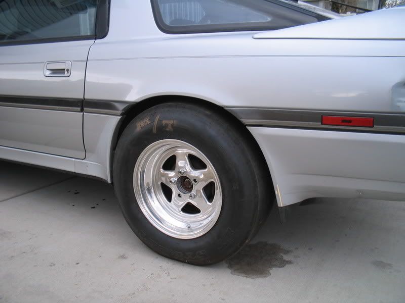

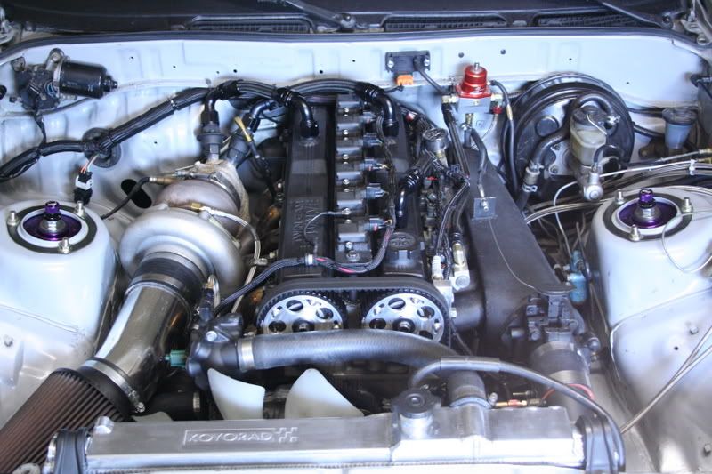

Here is your mod list.... To much to list so here are some pics.....This is way overkill for 11s but will get the job done none the less... 100% NHRA legal
This should you started on the long painful journey of spending every penny you earn... Now get out there and swipe a credit card
