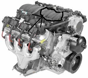

flight doc89 said:
Step two: buy LS-1
gsmokez said:
loll but i love the 7m:D
insert 7M-GE sticker from cam cover here:
you're done.
