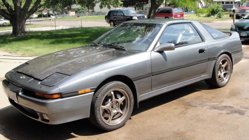

I love my ARZ brakes, and the 13" rotor kit fits under these 5Zigen FN01R-C's. I do have a 10mm spacer in there, but the 17x8 +45's would clear even without the spacer.
