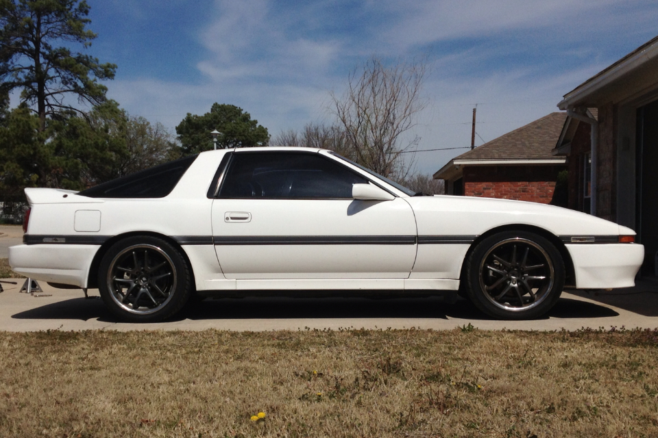

So let me update this thread. I did go ahead and buy the B&G springs. At first they looked good on the car and the ride was still pretty good but now all the wheels have a different degree of camber and it's sloppy as hell. I know it's not because of the springs. My car is in need of bushings all around. However when I do that job I'm thinking of just putting the stock springs back on with either some Tokico blues or Bilsteins, not sure yet. I'm also going to put some stock 91/92 5-spokes on. If you're wondering why, take a look at that blue car in my signature. That was my 91. All stock and rode better that my Lexus, seriously. I want that ride back. I like cruising in comfort. Here's a pic of the day I finished putting the springs on.

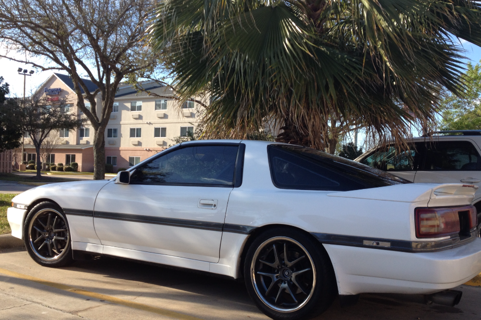

This is at TX2K13 a few weeks later.

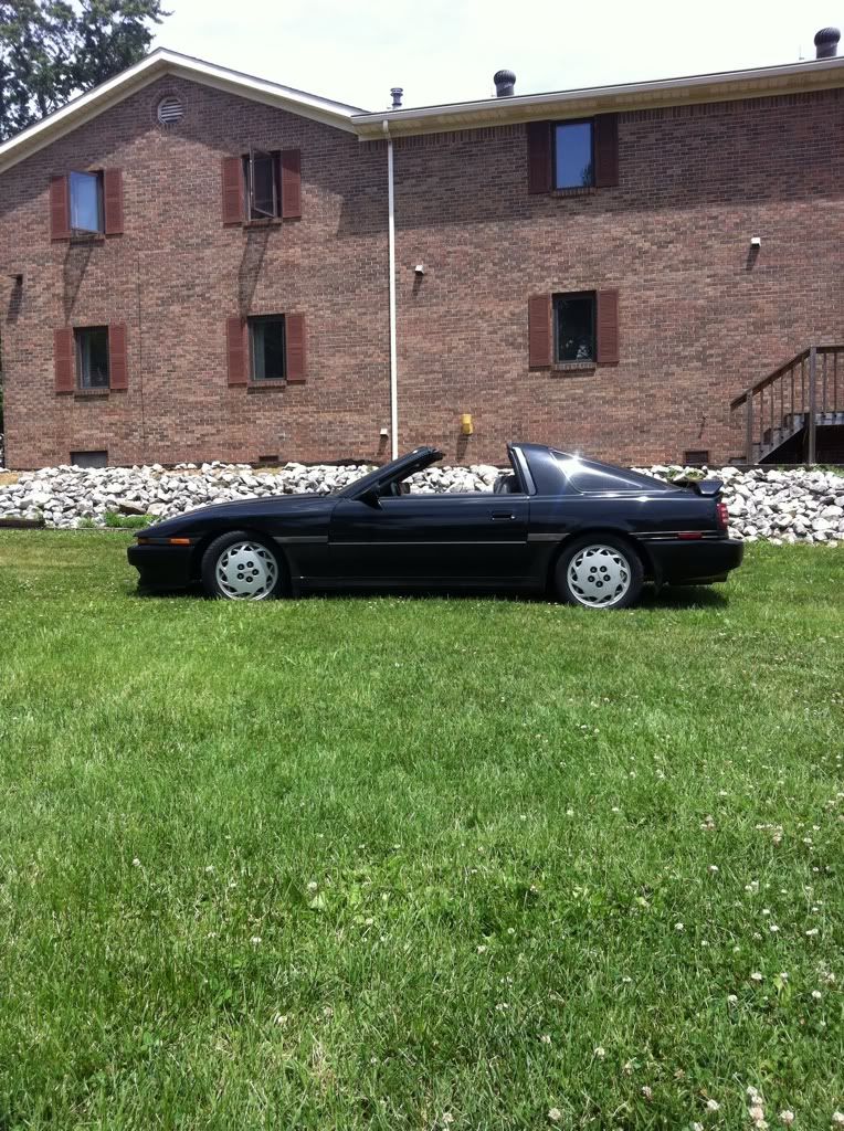

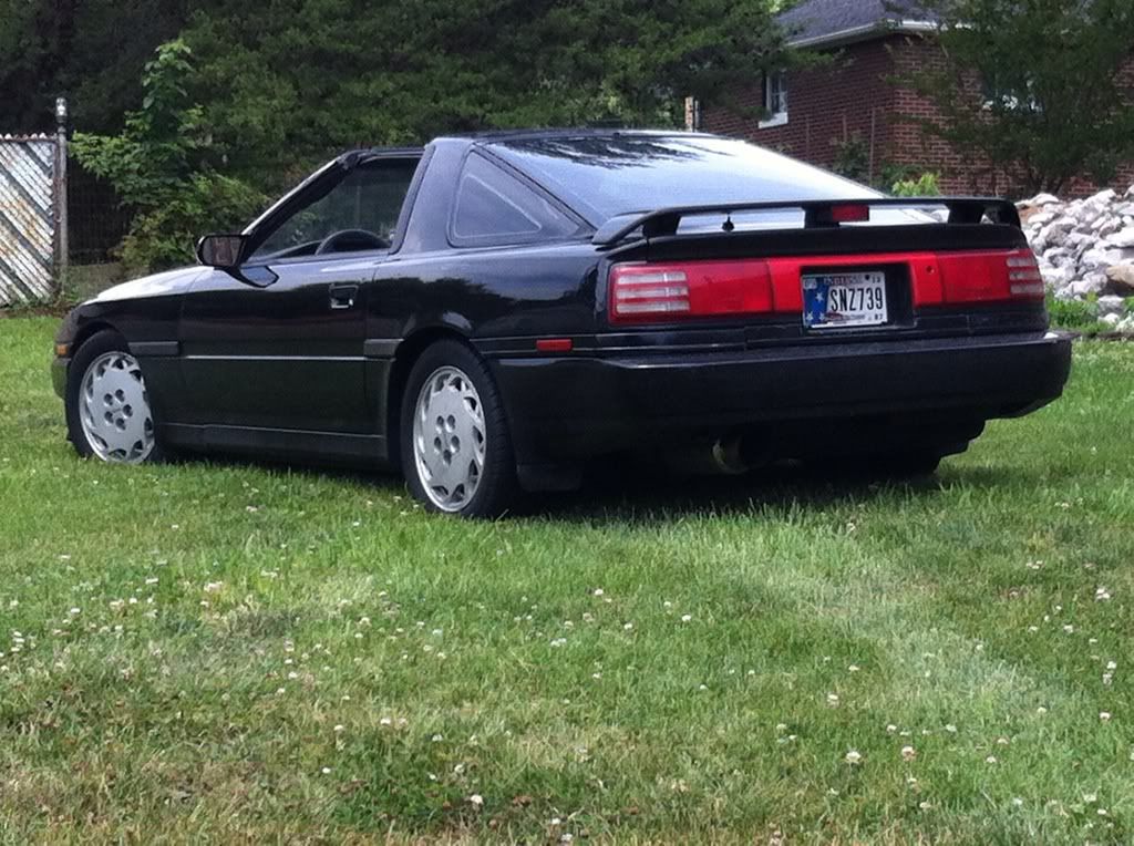

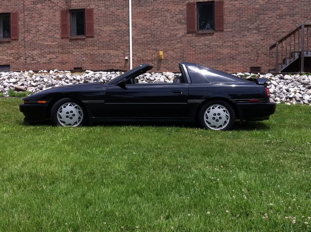

It is never fun when you take away from the Grand touring part of the MKIII. I do like the look of Factory 5 spoke wheels. Both the 16" and 17". Tein coilovers on the black car in sig pic. rides smoother than the lowered blue one does with lowering springs. Good luck with your quest.
