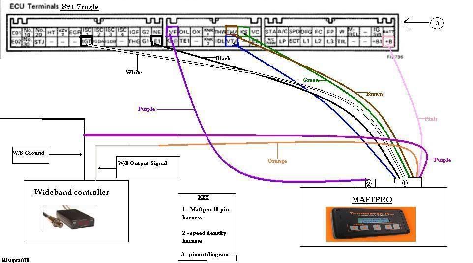

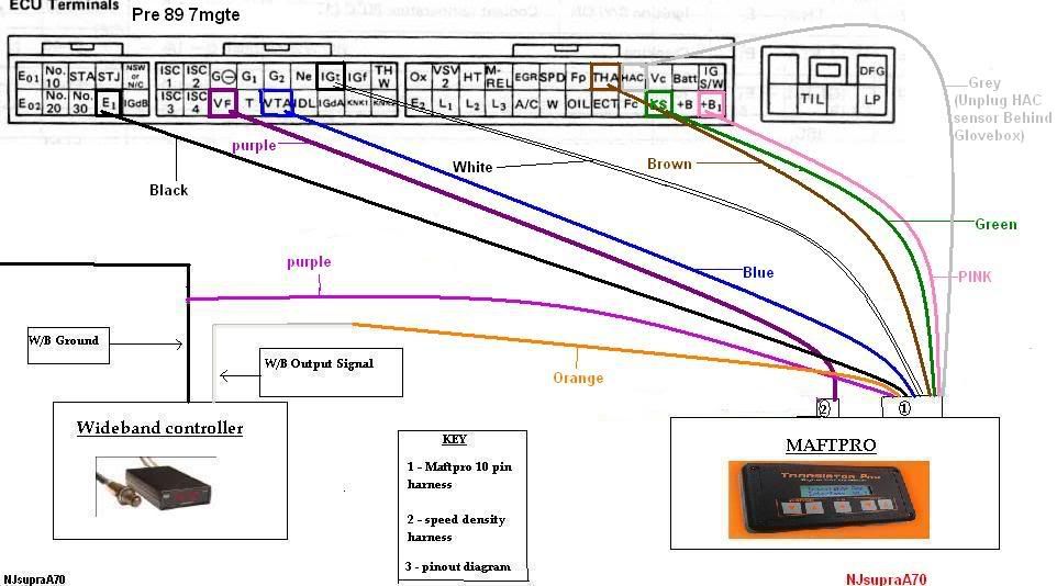

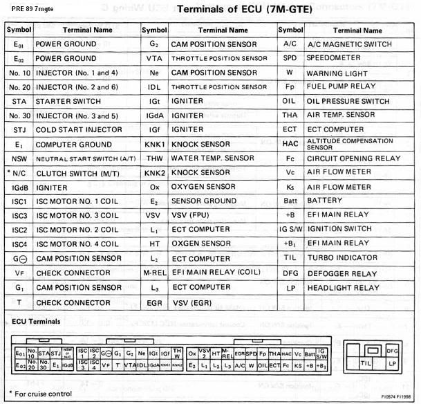

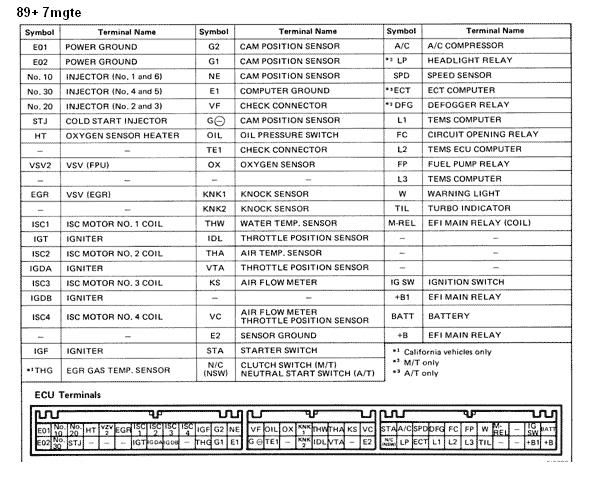

Unplug the Ecu connectors, and use the diagram below to guide you with the wiring. Both 89+ and pre 89 diagrams are pictured below.
89+ diagram:

Pre 89 diagram:

The install kit includes wire taps. Use these to tap the maftpro wires into the engine wiring harness. You must CUT the KS wire on the engine wiring harness, and the connect the GREEN wire from the Maftpro to the ECU SIDE of the wire. You can leave the other side of the KS wire unattached or you can connect it to the YELLOW wire on the maftpro harness(not pictured). This procedure for the KS wire is the same on a safc install. You will also notice that the speed density harness( #2 in my diagram) has its own loose purple wire. tap that into VF on the ecu pinout.

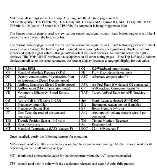

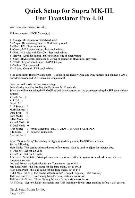

In addition the the wiring diagrms I made above here are additional instructions provided by full throttle tech. Also included below are all the settings you must adjust on the unit before using:
