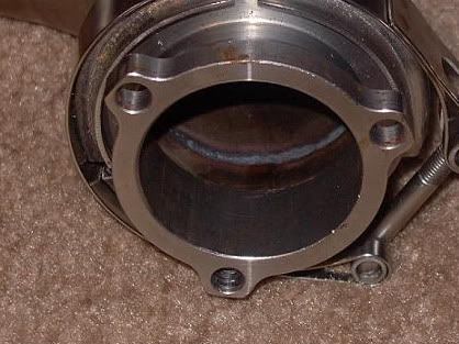

I need to make a custom downpipe for my Frank 5 20g set-up.
It's a T3 exhaust housing, however, I can't find this damn flange anywhere. I've ordered two or three which clame to be T3, however, they still don't fit.
I'd like to get a custom flange CNC'd. I can send you my current Trust elbow to use as a template. I don't know anyone near me with a CNC, nor do I trust any machine shops in my area.
Any help whatsoever is greatly appreciated.
-Mo
Here's a pic of elbow:

Edit: This is the original piece I had made by MDC. He made the downpipe and the T3 V-Band adaptor was made by ATP Turbo. However it doesnt fit. My plan is to just get an actual flange CNC'd and weld it the the ATP adapter. Voila, problem fixed...hopefully....

Bah. LOL. I tried! What's the inside diameter of your elbow at the exhaust flange? And the bolt spacing as well?

This looks nearly the same as the other I posted:
http://www.roadraceengineering.com/flangesandgaskets.htm
vs a your elbow image cropped:
vs your ATP setup:
The first pic I posted looks right, but without measurements off of it, I couldn't say for sure. Look at the spacing of the bolt holes and how far from the exhaust opening they are. The first image is MUCH closer to what you need than the ATP unit you have. (where the bolt holes are too close to the exhaust area)

A one off CNC flange from a machine shop will run you $250 at best. That stuff is not cheap.
Measure from the center of each bolt hole to the center of the other 2 bolt holes. Then measure the big hole. Tell us what those are, and we'll find one for you.
ATP has about everything. Make sure you look at the alternate model flange.
http://www.atpturbo.com/Merchant2/m...oduct_Code=ATP-FLS-018&Category_Code=ATP-FLS1

FWIW - atp has a "kit" thats $39 for the two v-bands and the clamp, and then if you want stainless you can call and sub them in and the price will go up...
but to the opener, you could trace the design on some really thick paper that way you can just mail it to sethron instead of shipping the entire elbow...
another thing though is i would call atp and talk to them, give them the bolt spacing and ID of the hole, they should have a file for it.
If not im sure they could make it for a lot less than most of the users on here with a/access shop

Mo needs to measure what he's got there to erase the confusion. It's problee the alternate flange there.
