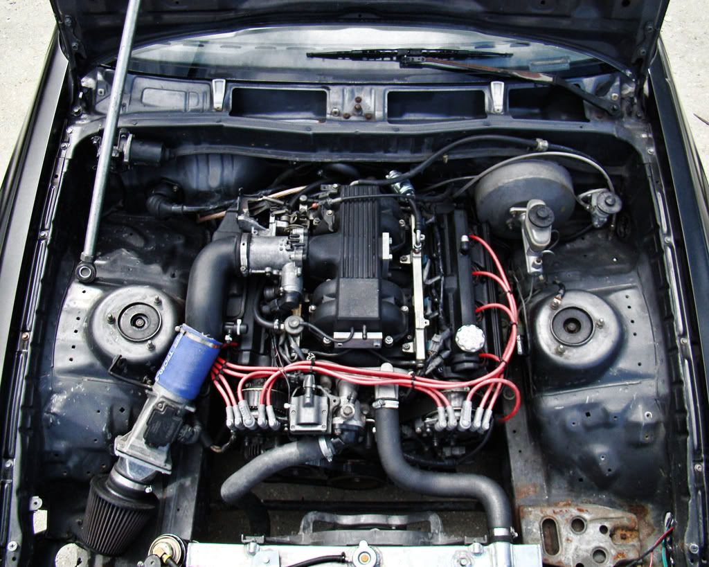

Greg55_99
Apr 2, 2005
55
MA
jessetooslow;1266060 said:
I was looking about this swap, how difficult is it, is it a straight foward swap or is their alot of fabrication involved?
Snaked it off of Ebay.. This would get you started if you have an R154.
Greg

jake breyck
Aug 8, 2006
33
fl
Its a 1uz from an SC400, but ya any of the lexus 400 cars.
the swap is easy, and you can do anything to it that you can do to any other motor. and there is decent support for parts. check out www.uza70.com i sell everything needed to do the swap to a mk3 supra.
