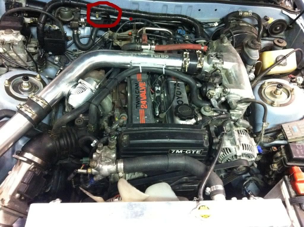

There are a few variables you need to take into account, but 43psi with the Vacc line blocked is a good start point.
The way it is now I wouldn't let it come on boost at all as "incipient detonation" will kill the engine without you even knowing it's happening.

what do u mean by vacc line blocked are you refuring to this?
I circled it in red
