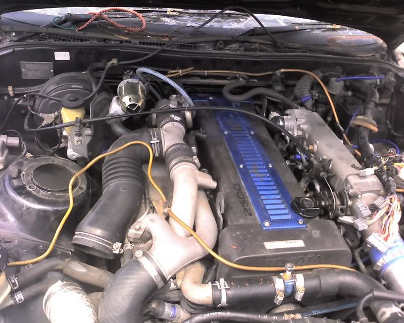

There's no ABS on the clip. I'm only Cletusing a few things now but the brake system will not be one of them, lol. I'll be using the lines from the clip, so they will be meant for RHD.
I feel incredibly stupid that I haven't realized that I could use the lines from the clip until now. Lol. Oh well. I wasn't thinking straight.

I know it's worth keeping. Maybe later on down the road, when I have more money to throw at the car, I'll get it with brand new lines. As for now, I'll keep everything simple when I do the swap.

all I see is a hole with it gone...
you could polish it up or something, nothing really bad about having it (unless of course you get air in it and it's a bitch to bleed the air out...)
